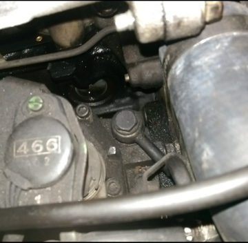

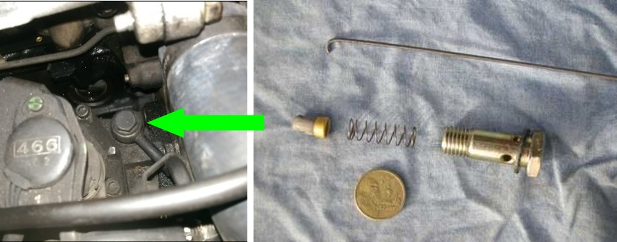

Where is the filter on the inlet side of the pump? Are you referring to the banjo screw? I believe there is a filter in there?

Posts: 10963
Re: Issues since being laid-up
Post by g8dhe » Mon Sep 20, 2021 2:47 pm
The Banjo filter is as below;
