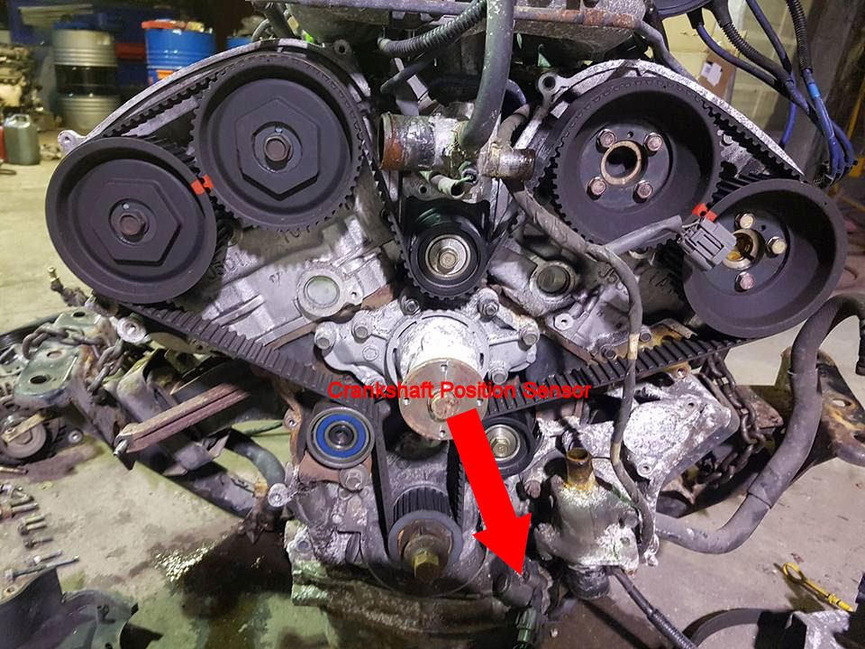

Could be an intermittent sensor, not heard of many problems on the V6 however, but can't be rules out without checking its 18-230 on this diagram http://www.lushprojects.com/bongopartsm ... no=.html#2

Geoff thanks for the information. I know it may be basic to some but I am having trouble actually locating the sensor. I have searched the forum and although there is a photo I cannot make out where it actually is? Any pointers appreciated.

Yup here is the position, bit of a sod to reach I think. If you have a meter its should show a resistance of 110-150 Ohms.

Post by Eratosthenes » Thu Oct 03, 2019 9:46 pm
Geoff - that's perfect - many thanks.

Post by Ian » Fri Oct 04, 2019 9:35 am
Yes, well done Geoff for removing the engine from your Bongo just to take a photo of the sensor. Hope it doesn't take too long to re-assemble it....
