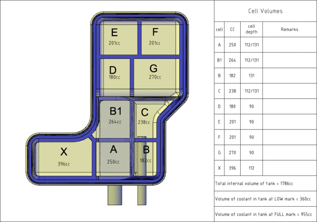

Not sure you will find sufficient room, the animated image from Steve Widdowson's work;

Doubt very much there would be space for it inside, also I doubt it could seal and not leak under pressure.

Geoff's answer explains why this won't work really well. There are baffle plates all across the header tank. are you aware there are several low water alarms already out there that will do the job very well. This one from Haydn is the one that I have used and it works very well saved my new head gasket just last week! http://www.coolantalarm.co.uk/shop/inde ... roductId=3
