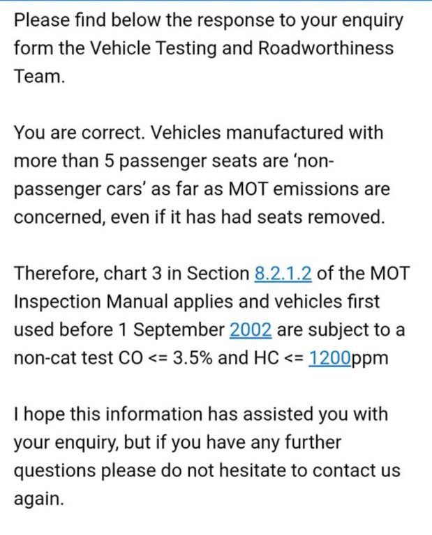

I've seen reference to this on FB a couple of times and a couple of MoT Testers have confirmed this interpretation, however if this is a 2002 vehicle it needs to have been manufactured before 1 st Sep 2002!
