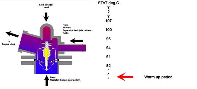

Re: Radiator fans running, after 25mile commute
Surely you expect the pipe from the radiator to be cold ? Its the cross flow over the top of the thermostat that is the flow to be cooled down ? Click the image for animation ....
