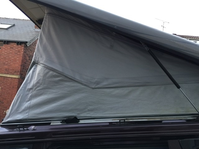

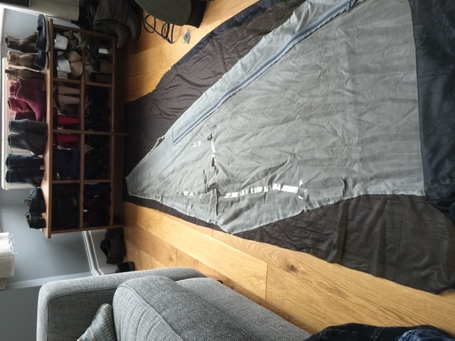

cwilliams255
Posts: 124
Location: Sheffield
Re: Removable fly netting repair
Post by cwilliams255 » Wed Sep 02, 2020 1:55 pm
I think so long as the existing one isn’t in too many pieces then it should be easy enough to get it right. I made a template out of a load of sheets of paper so I could pin and cut the new netting. You do need to make sure the tent is back in the frame carefully though as the back corners under the motors are under reasonable tension and could rip or at least they were on mine. I deemed it worth the risk as mine was in pieces (see images)
Original against new black netting (too elastic)
New netting in place
I had no problems with roof afterwards, it didn’t reach full extension without a little push before hand :)

Post by Roy748 » Wed Sep 02, 2020 6:51 pm
Thanks for the photos 255, mine is fortunately better condition with only two tears, one either side, so hop8will act as a good template.
I see you did not include a zip mid way in the netting.
