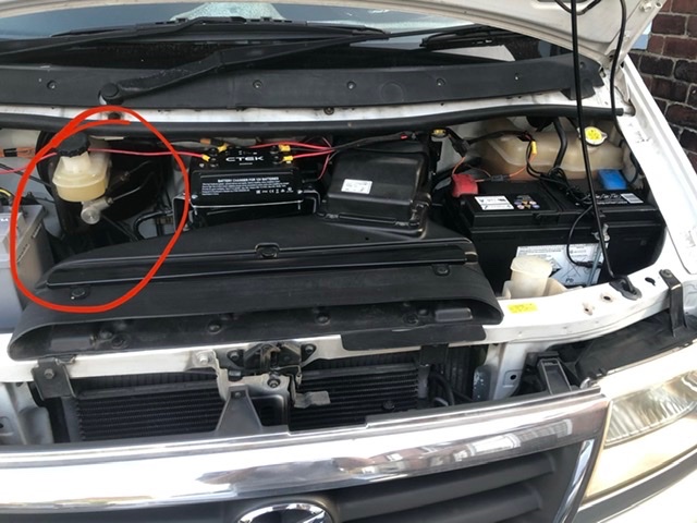

On the subject of tiny tanks, I could only find space for a 2.5L tank on my v6. I’ve seen some bigger ones near the radiator but I wasn’t that keen on it being there. It’s still 10 hours on full whack and I think the most I used on old diesel one was for an hour to warm up in an evening and morning

cwilliams255 wrote: Mon Oct 12, 2020 8:01 pm On the subject of tiny tanks, I could only find space for a 2.5L tank on my v6. I’ve seen some bigger ones near the radiator but I wasn’t that keen on it being there.
Where did you fit the tank?

nth wrote: Mon Oct 12, 2020 8:02 pm
Don’t have a pic to hand fitted but here
Made a bracket to attach to front support but that runs across above radiator
