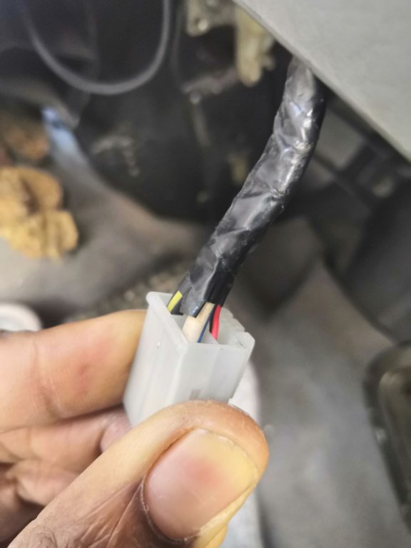

I know that this is a subject which has come up time and time again but I'm struggling to get my head around what's happening in my 1995 bongo with manual heating controls. I suspected foul play when I had NO demister button but did find the 4 pin female plug lurking behind the dashboard . I bought a button from a breaker that blew the fuse even as soon as I pressed it !!!! The button did not appear to click in and click out, so think that this button is also faulty (I hopefully have another one coming tomorrow)
WIth a new 30AMP fuse in place but with NO switch now, I see 12 volts at the white thick wire. The thick black and yellow cable, the thinner red and thinner black wire (not in view) all appear to have continuity to ground which is confusing me. I am assuming that the black and yellow cable becomes live once the switch is pressed and the remaining thinner pair of wires to illuminate the switch when pressed.

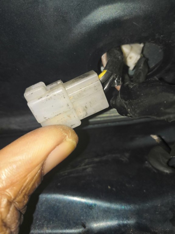

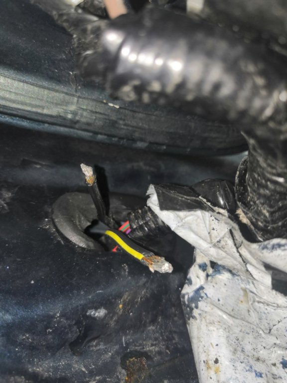

The wires in the tailgate hinge were damaged and were resoldered
BUT the black and yellow wire here, is part of a two pin plug along with a plain black wire . With this two pin plug disconected from the tailgate I still see continuity between the terminals on both the powerside and tailgate side of the plugs.
I'm just wondering if anyone has investigated this particular circuit here as wondering if I do have a short somewhere. I wouldnt expect the black and yellow wire (which I assumed was the live power) to have continuity to ground on the powerside of the plug whilst disconnected from the tailgate. I have removed both trim panels on the drivers side and tapped into the both B&Y and the black wires between c and d pillar and by the rear heating controls before the loom disppears under the floor towards the front of the bongo. They both have continuity between eachother /ground

Looking at the colour cables into that 4 pin plug under the dash , it is black , red/blk, blk/yellow and white/blue which relates to I1-02
The loom looks pretty sound from the moment it comes up into the cabin behind the drivers seat, they're not unwrapped/disturbed right up to the plug, which I've disconnected, below the right rear window below between C and D pillar (before it disappears behind offside lights and out of the body by the hinge)
I'll try and isolate the blk and yellow wire but it seems connected to earth both with no switch and unplugged between C and D pillar , maybe the issue is between the under dash plug and where it disappears under the floor. I'll keep looking.
