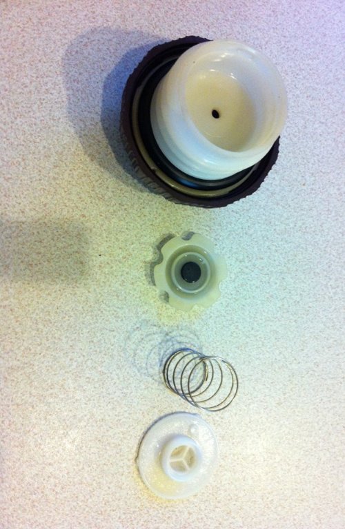

Try loosening the fuel cap and see if you get a 'whoosh' of air.
Possibly the breather blocked?

I'm pretty sure Geoff has put up some pics on how to dismantle, and then clean, the filler cap. :)
Posts: 10884
Re: Starting problems
Post by g8dhe » Mon Feb 01, 2021 1:59 pm
The valve in the cap is just clipped in, there are a couple of variations can't remember if that was the diesel or petrol version but they are similar.
