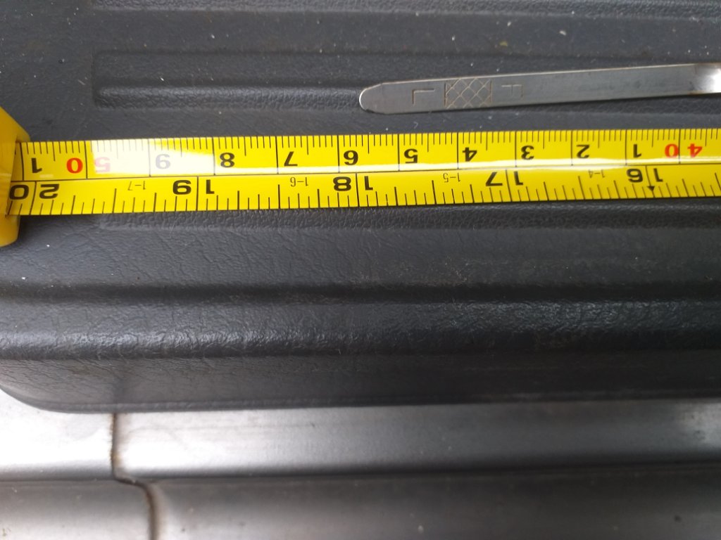

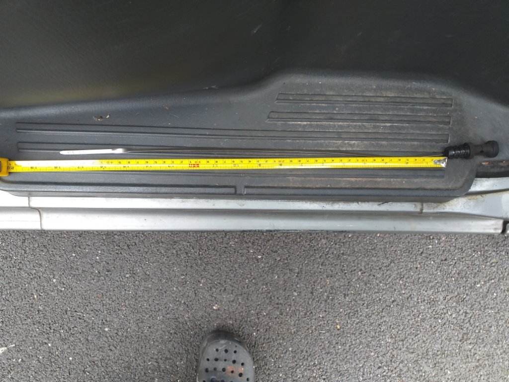

Posts: 15483
Re: AUTO GEARBOX DIPSTICK LENGTH
Post by Bob » Wed Mar 17, 2021 1:27 pm
Looks like the correct dipstick. 8)
Tomd
Posts: 11
Joined: Wed Jul 29, 2020 10:36 pm
Post by Tomd » Wed Mar 17, 2021 8:26 pm
Many thanks for that info and pic, looks like I will have to syphon some fluid out of my gearbox!!
