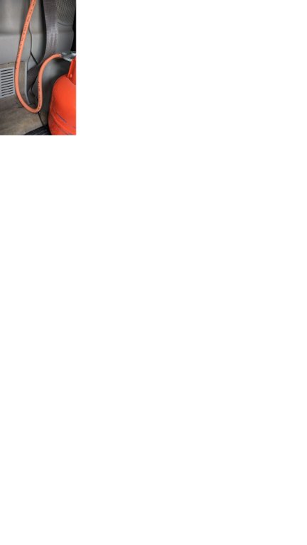

I have a combination sink and hob installed in a side conversion. The conversion was done before I bought the vehicle but was all new.
I can't seem to get any power to the sink pump to pump water.
It seems to be wired into a black cable that runs behind the side card. See pic 1.
This then reappears further towards the rear of the van and then goes down behind the right rear trim. See pic 2 and pic 3.
Does anyone have any idea what these may be wired into? I've tried the aftermarket fog light but had no success.
I realise all conversions are different but any ideas are gratefully received.
Thanks Steve

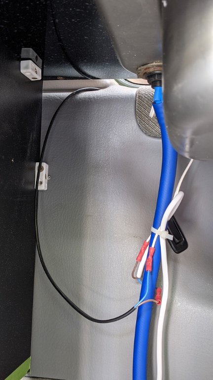

Have you removed the connectors from the switch on the bottom of the tap, checked if there's power, then checked the switch itself?
If that’s ok I'd check the pump from a direct supply. [-o<

I notice that the Brown wire isn't attached not sure where the lead goes but I would expect that to be connected as well!

I had to look really close, but I think the lower brown is connected to the blue, from the switch, which passes behind the water pipe.
I think. :)
Posts: 10964
Re: Sink pump wiring
Post by g8dhe » Sat May 15, 2021 10:04 pm
Yes think your right Bob!

I'll have a look around for a control panel or switch and test the wiring to see if it's live.

If the pump doesn't have push on connectors you can likely get a probe into the crimp connectors. 8)
