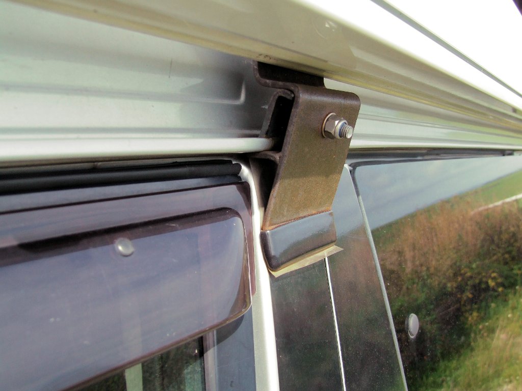

You need the rain gutter to mount the brackets on, but some after market roofs get in the way it appears as you need some space behind the gutter. Mounting to the gutter works OK, there will be some twisting, but it doesn't seem to have any detrimental affect, the rear mounting has to be carefully positioned to keep clear of the side window but not to far round the rear curve!
