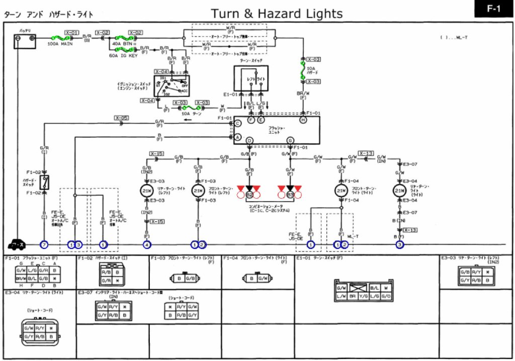

The indicators have stopped working, the hazards are working, I've changed the small fuses by the steering wheel, which has sorted the door speakers which are now working again. However not the indicators any help would be appreciated

I would be a bit concerned as to why you have so many blown fuses!
The Indicators have two fuses involved and it sounds like you may have blown the 10 Amp one that feeds the stalk switch;
The specific fuses are listed on my wiring web site http://www.g8dhe.net/bwm use the "by problem" tab and select Turn & hazard from the dropdown list.
