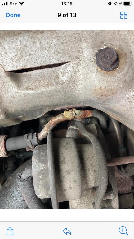

I've been taking a few more pics and found what looks like a suspicious leak however, not sure if it's related - does anyone recognise this one on the passenger side?

Yes, quite possibly Hayd - the alarm was going off but as my coolant tank is rather yellow you could never really see the level. What the consequences of trapping air?

Trapped air will lead to overheating and cracked cylinder head.
