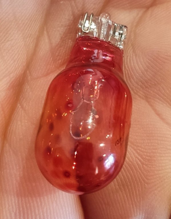

It seems as though it is a wedge type bulb

This is the old bulb, unfortunately it doesn't have any markings on but I posted before that it was 21W

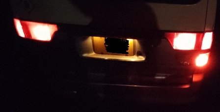

Post by sotal » Thu Dec 02, 2021 1:16 am
All working now, happy with the result although it was more of a pain than I'd have liked.
Very bright now, the photo doesn't really do it justice. But you can probably tell that it is a good bit brighter than the tail lights. Very red now too :D
I was always a lot happier with not having the dangling type on the bumper, but was always disappointed with the pink light before. This is spot on now and could actually function as a fog light too!
