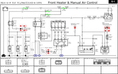

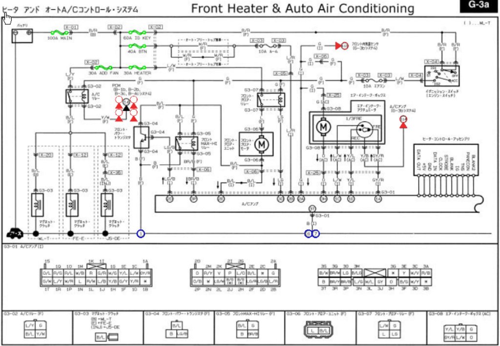

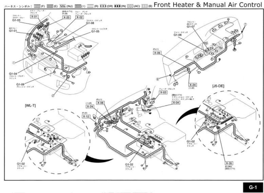

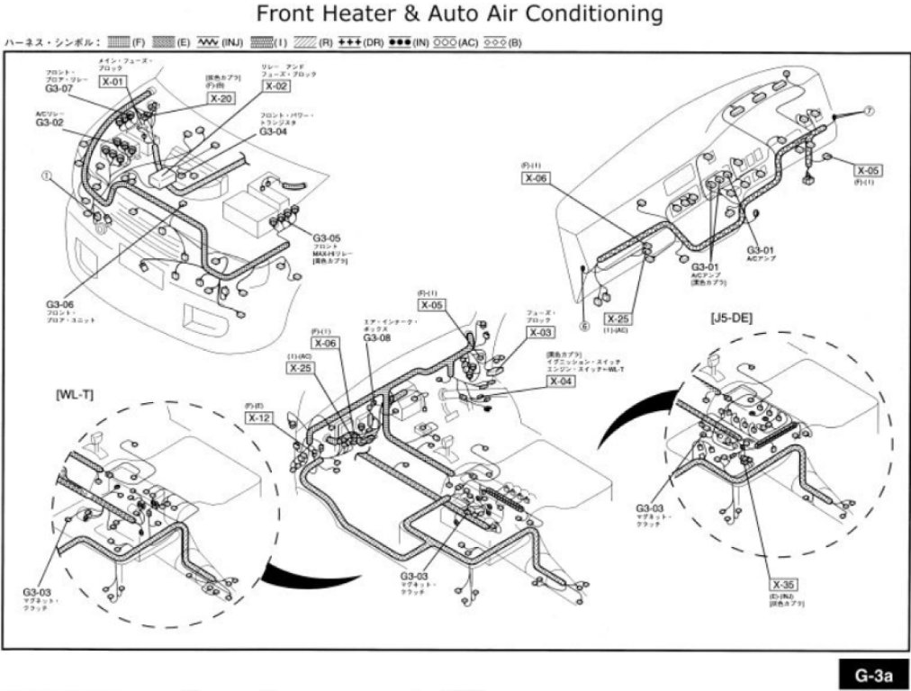

Here you go diagram and locations for front air con climate control type - if your a manual slider variety let me know!;

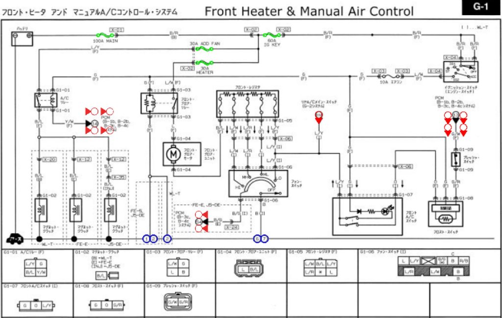

Ah you have the older manual type of controls;

Well thanks to the schematics posted and my boss being an ex Audi master mechanic specialising in electrical systems he used the diagrams to solve my problem, and as it turns out I made a mistake and put one of the fuses under the steering wheel in the wrong place, haha.
Plus side i striped everything down put new resistor and relay in and cleaned and adjusted the fan itself and brushes ect so now it's perfecto thanks again for all your help
