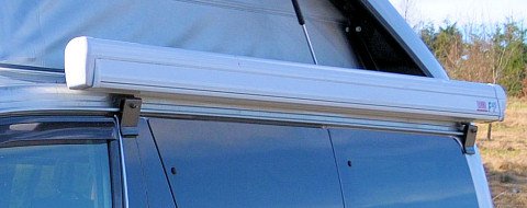

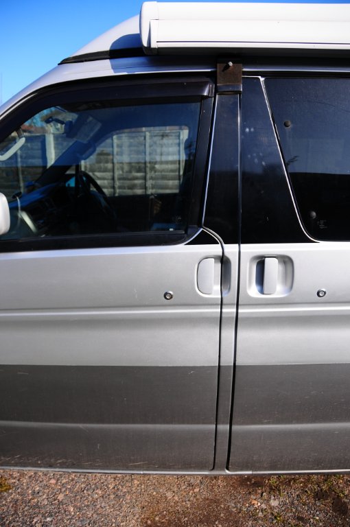

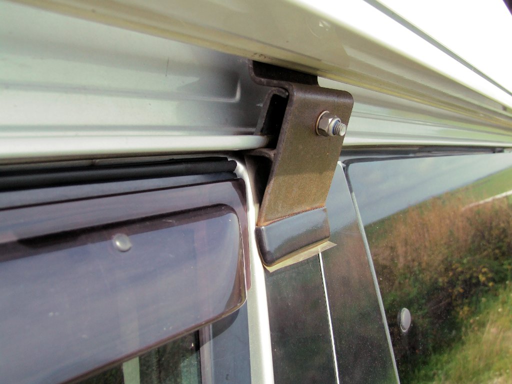

This is the brackets for the F45, the attaching bits are much the same as for a F35 (its the top which holds the awning thats different).
As to a Mushroom roof I understood there were problems with these in that they come down into the gutter (not studied them in detail) and hence cause problems for attaching awning mountings ? The two pictures which show the "B" pillar supports best are below. I no longer have that vehicle so can't take any more pictures !
