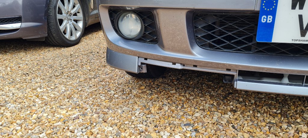

Hello - can anyone tell me which part I'm missing from the front of my van? I bought it like this and I don't know what to search for to replace it!! See photo - thanks :) :D

Your missing the section of plastic bumper that covers the towing eye, its fixed in place with a single scrivet and can hence be easily lost!
51-9K0 on this image http://www.lushprojects.com/bongopartsm ... 02.html#18

Any idea where I might source this part from?

I've seen a few vans with that bit missing. An opportunity for someone with a 3D printer I think.

You might get one from a breaker, ebay, Facebook etc.

Just to revive this thread, I'm starting a project to try & have these available in ABS plastic & carbon fibre reinforced plastic by early August. Have just purchased a 3D printer big enough to manufacture them in one piece. Website will carry updates on the design process & progress, I'll be 3D modelling & prototyping this month. Any other parts you're looking for, let me know, I can do approx 400mm long parts, so these pieces of trim, the tool door hatch etc, which I'm going to do for myself in carbon fibre reinforced because it gets a lot of kicks from the step.
