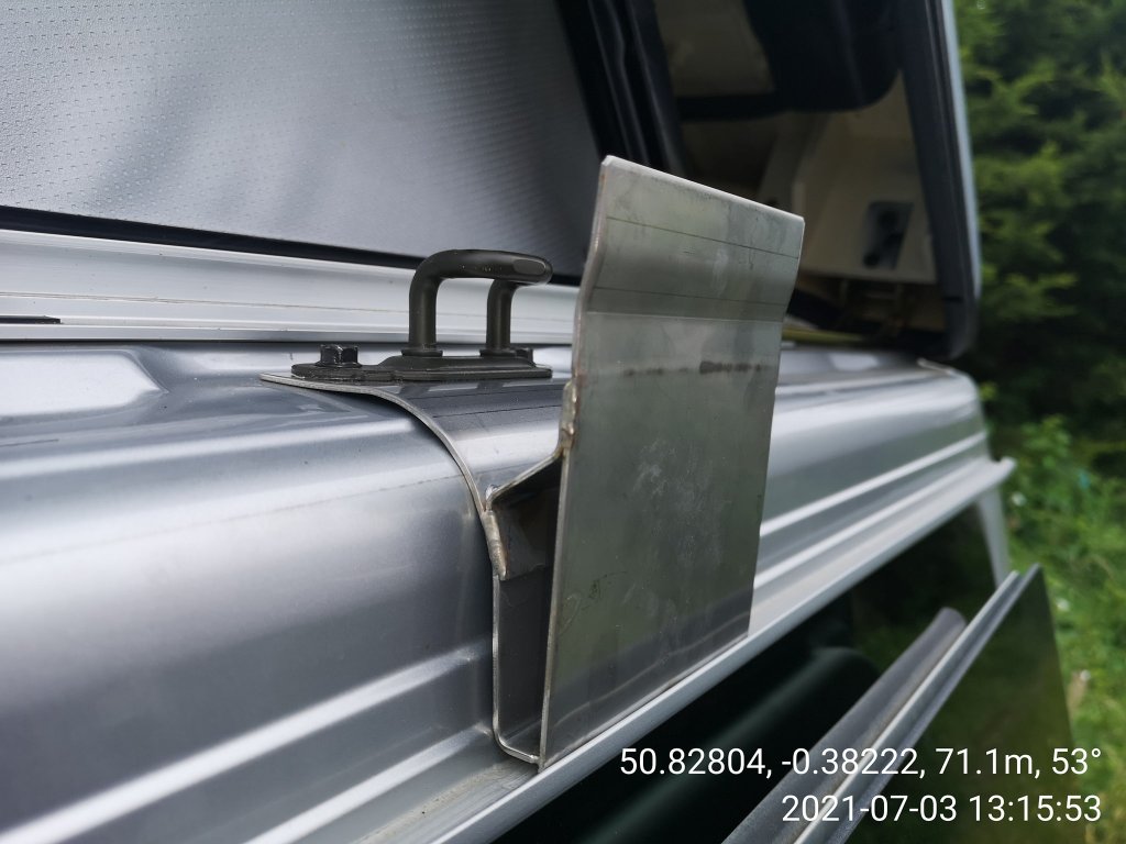

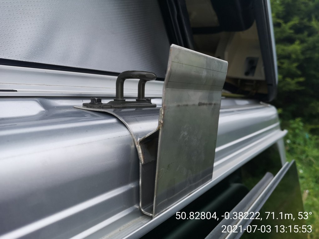

Normally 2.6m length fits nicely, brackets depend on your roof if you have an AFT then Dave Westgarth (on facebook) does a brilliant bracket than any of the advertised ones which goes under the existing old awning brackets;
They mount very firmly no vibration, no strain on the rain gutter either. and very easily fixed to the van and awning to the bracket.
