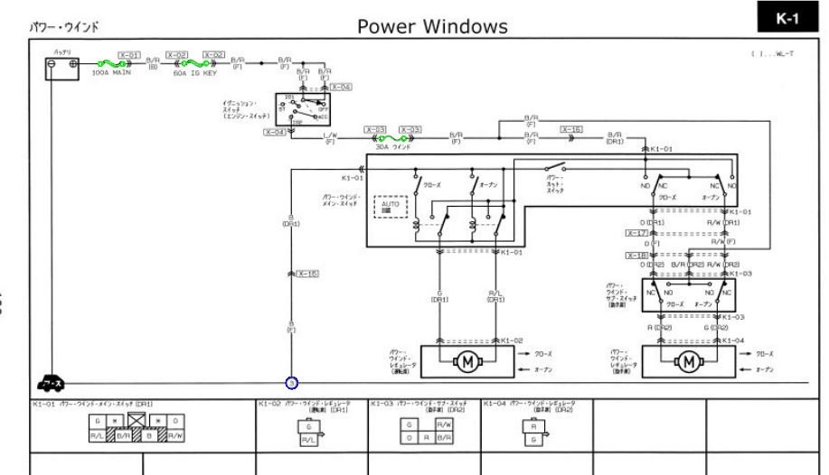

My bongo has at some point had the window switches replaced with the 323 version so switches operate around the wrong way. Looking at the wiring diagram it looks like I can "just" swap the 2 pairs of wires (Orange + red/white with green + red/grey) over on teh edge of the connector and it will revert to working correctly, what am I missing?

That is correct, but check it out with a meter after the wiring changes BEFORE reconnecting the battery, as get the wiring wrong and you will burn out the PCB track inside the switch case, they can be repaired but are a pain to do!

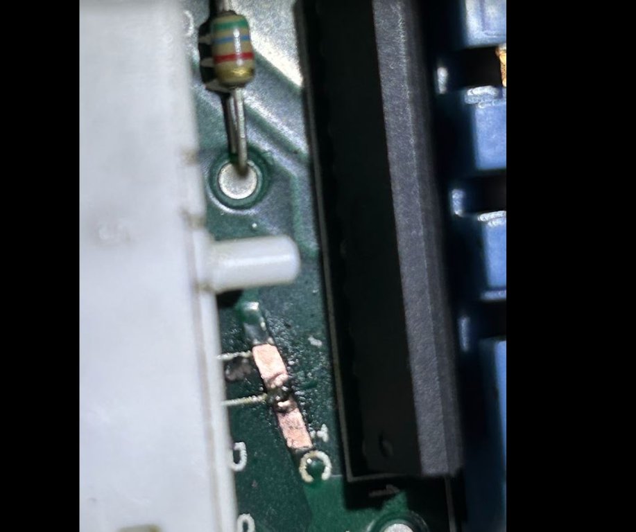

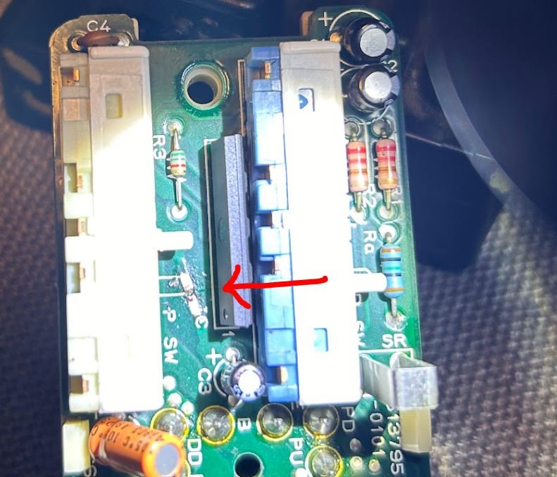

Found this…
Switch got a hammering this morning while I was changing a quarterlight. Maybe too much for it?
Posts: 10941
Re: window switches
Post by g8dhe » Mon Jan 15, 2024 7:42 pm
Yup that looks like the problem!

Post by Mark-H » Wed Jan 17, 2024 1:42 pm
Bridges the broken track and now all working. And around the right way. Guess a rogue door wire caused it to blow but far too cold to be messing with stiff wires. Will just have to pretend it’s not a problem for now!
