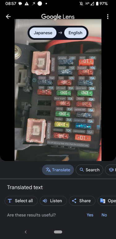

Yes there were two fuses installed into a cable that was coming off the leisure battery and they were both blown. The leisure battery was definitely already dying when we first got it as I did a voltameter(?) test on it and the number was lower than what it should have been - but now maybe the battery has completely died hence the problem.
I now just need to work out which fuse slots the wire ends were in in the fuse board, I think because the fuses that the garage put in are slightly different I can work it out. I used Google translate (with the camera function) to translate the Japanese and looks like one was in "cigarette lighter" and one was in "room" (?) - would that make sense? I guess room could mean the back cabin?
Thanks again for the help!

Post by g8dhe » Sun Mar 31, 2024 9:18 am
Yes the are 4 circuits that might be transferred across;
Normally the old fuses are placed into the additional fuse box under the bonnet that is fed from the LB, if you do have problems in the future, all you need do is move the fuses back inside and remove the wires to place the circuits back on the S.
