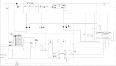

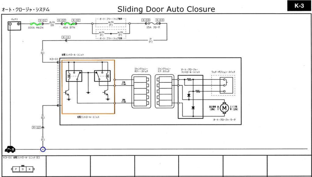

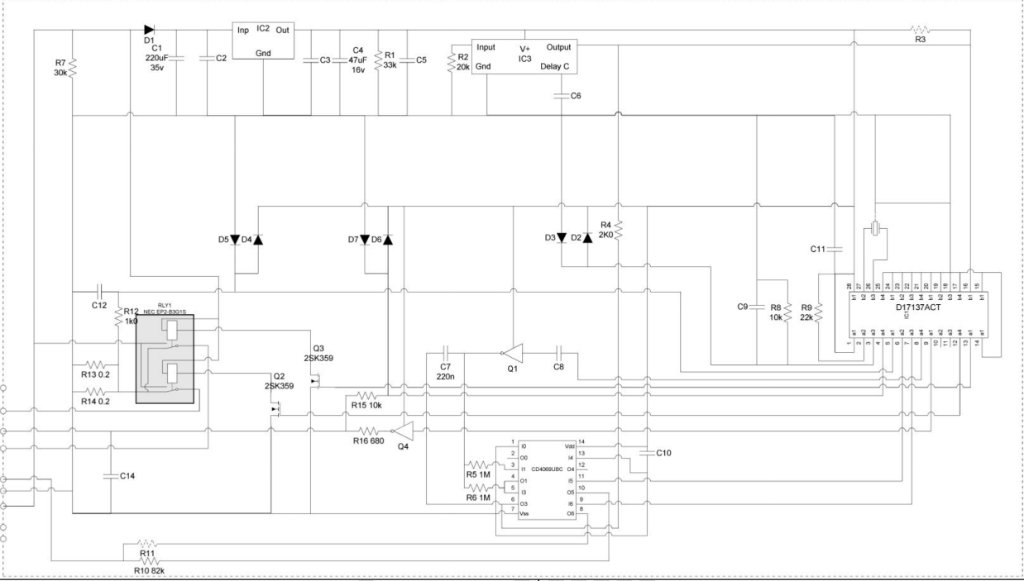

In the "B" pillar is a yellow control module, this contains a dual relay (sealed type) and relevant circuit, diagrams available in the online diagrams if you use a browser capable of Flash; low quality screen grabs below;
