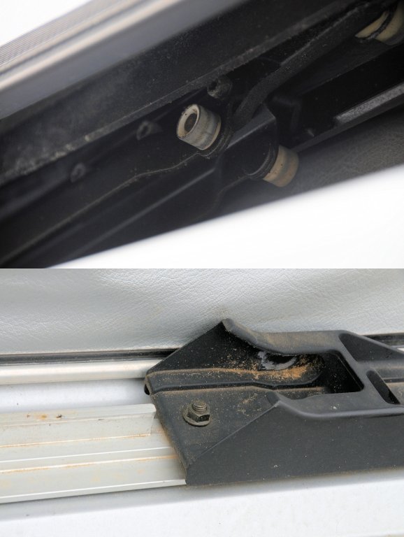

There is another method but it can be just as fiddly, it involves pushing thin rods or garden canes under the front lip of the roof so that you can push the sliders backwards, but if you have never seen the arrangement under the front of the roof it can be to get the rods/canes aligned to push on the sliders;
