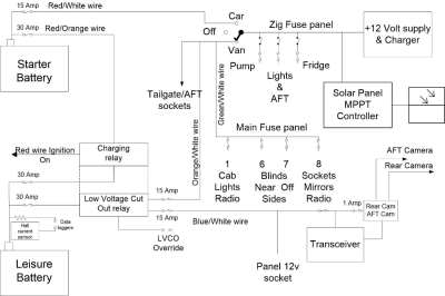

If its been converted/used as a camper van at all then its very common to fit a Leisure battery so that you have power in the rear of the van when the engine is off. Its normally (but not always) fitted under the bonnet on the nearside where there is a space designed to fit a second battery in a Bongo specifically for the Cold Start Northern Japan model. This battery then has an added Split Charge Relay to allow charging when driving from the alternator, and then 4 circuits are diverted from the internal fuse box across to this battery, along with any added wiring desired. Often in addition you can have Electrical Hook Up (EHU) fitted to allow charging and running the rear of the van when static on a campsite and/or Solar Panel mounted on top in parallel with the EHU to allow of grid camping. All of these additions are after market additions added in the UK and is what makes the van such a great camping vehicle.
A typical battery / charging setup is shown below;
