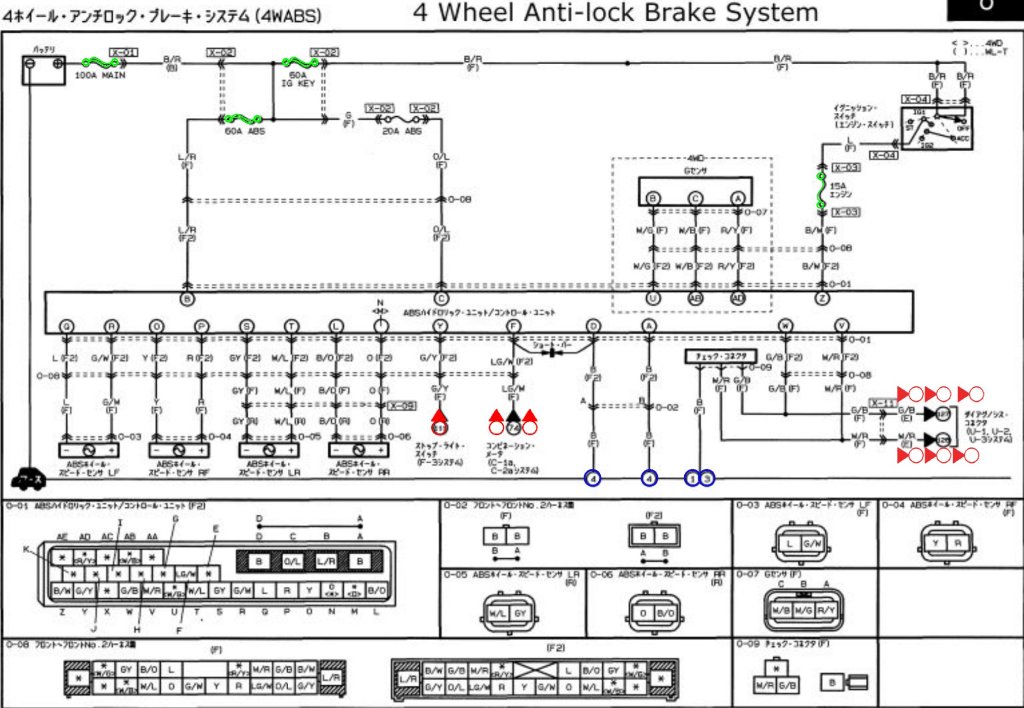

Yes not all codes seem to be listed however 44 is noted in this discussion and normally 43 might be the righthand side sensor https://igmaynard.co.uk/bongo/forum/vie ... 07#p630907 Might be worth checking that the two new rear sensors are both operating and connected to the control module by checking the resistance at the module ?
