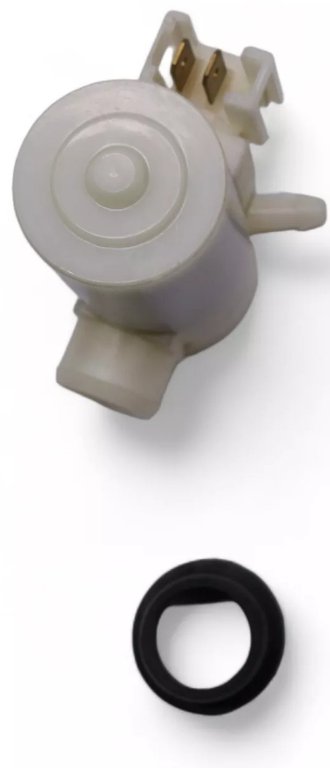

Post by g8dhe » Mon Oct 20, 2025 2:16 pm
I think you can reach the rear pump, but does depend on the size of any LB! They are simply "O" ring force fitted into the side;
