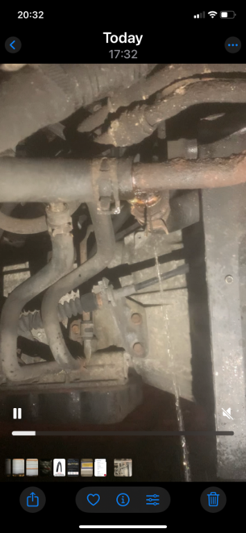

When I pulled up outside my house tonight,I could hear coolant leaking under pressure from the tee under the drivers side near the rear heater. Could anyone recommend the best way to repair this as I can’t see anything in the members area I have attached a photo of the leak.
Thanks Stephen

HI, common problem, but you don't say which engine, the piping varies a bit between them, however is it a metal pipe or a rubber pipe? Simpler if its a rubber pipe or a seal to a metal pipe that has failed! Best to check the diagrams for the cooling system and/or rear heater from the diagrams available here http://lushprojects.com/bongopartsmk2/ Replacement parts from either eBay or one of the dealers can normally help;

Thanks for your reply I will take a look ,it’s a v6 petrol I am also hoping to by pass the rear heater as this isn’t used any more.

Pretty standard mod, you will be fine with that.

A bit of an update after looking through past posts on here, I worked out how alter the pipe work to remove the leak and rear heater bled the system which was the bit i wasn’t looking forward to but went surprisingly well.
After a week of use I have had no overheating or lost any coolant so all seems good.
