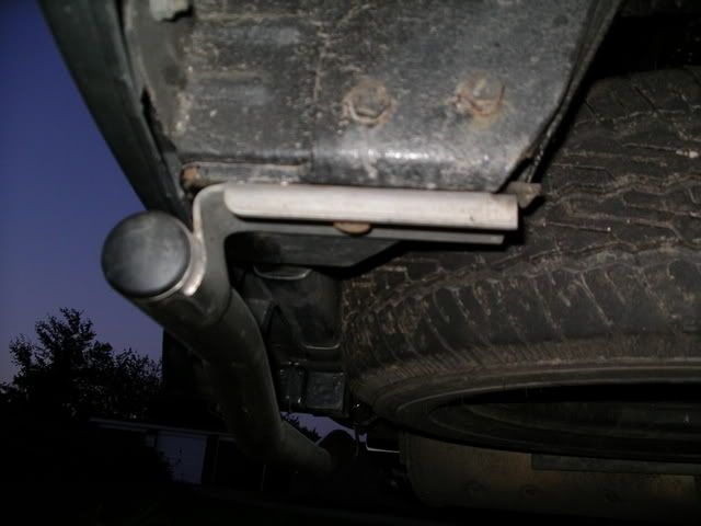

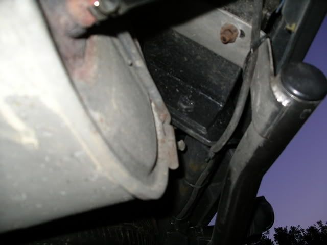

Post by Simon Jones » Thu May 03, 2007 8:35 pm
View of drivers side bracket - this mounts via horizontal bracket thru the chassis:
The passenger side bracket is angled upwards & again mounts thru the chassis:
The bar should have come with 4 bolts & 2 metal plates with captive nuts that slide into the box sections of the chassis. As I already had a towbar fitted, I did not need these bolts & plates, so just fitted the bar to the existing bolts.
