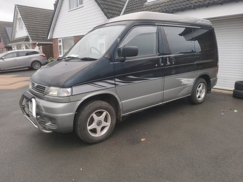

The short version is I bought a rusty bongo did nothing about repairing it for 3 years then I've just bought a solid bongo with a broken engine so I'm putting the engine from the rusty one into the other one.
That's the rusty one there, looks quite deceptive but drivers sill has gone completely all, the way up into the main floor.

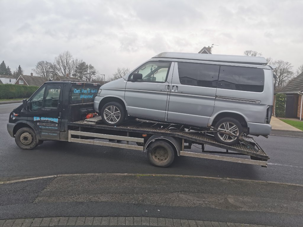

The rusty one making it's final journey.

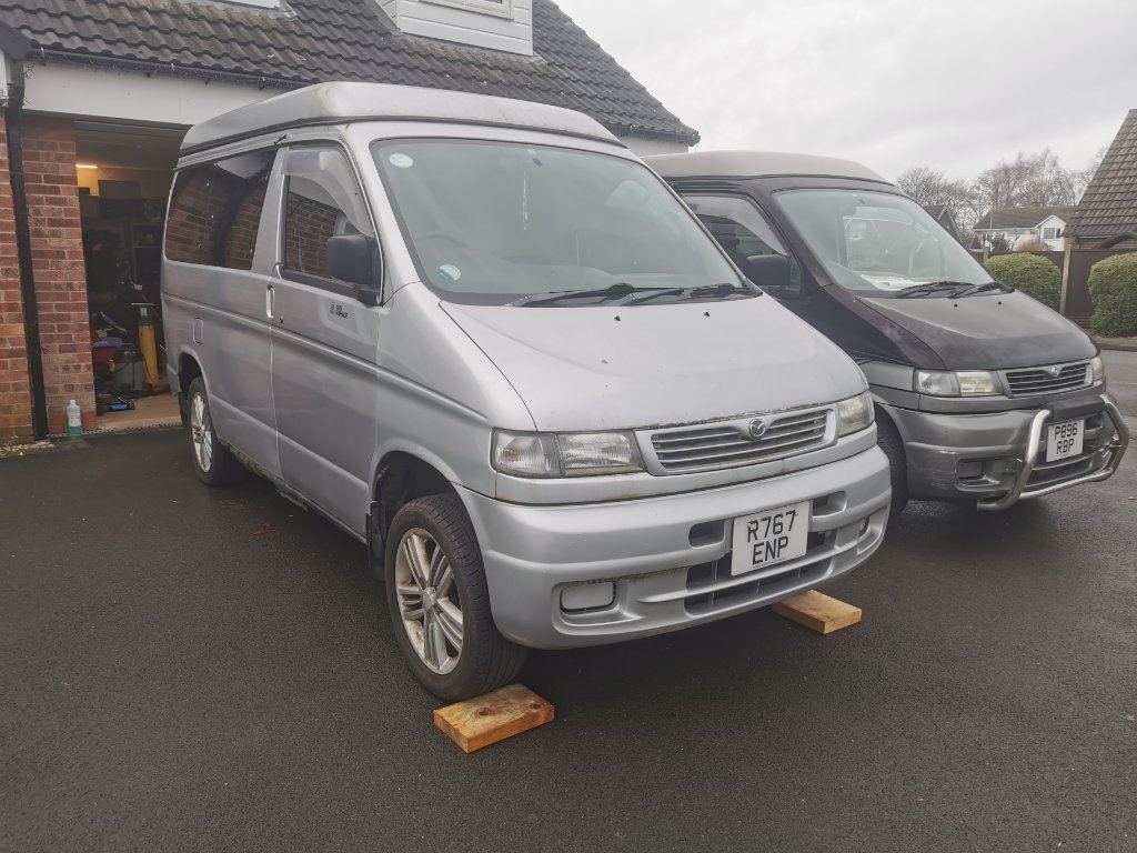

Enter the new bongo, she's got a few marks but given the age I'm fine with that.
I plan to remove the broken engine and box in March, this will be followed by a good look at the chassis which. I'll do any necessary repairs on and under seal.
The new engine and box will go in and then I should hopefully be good to go for the summer, I kept a few bits off my old bongo that were in better condition so they'll also get fitted.

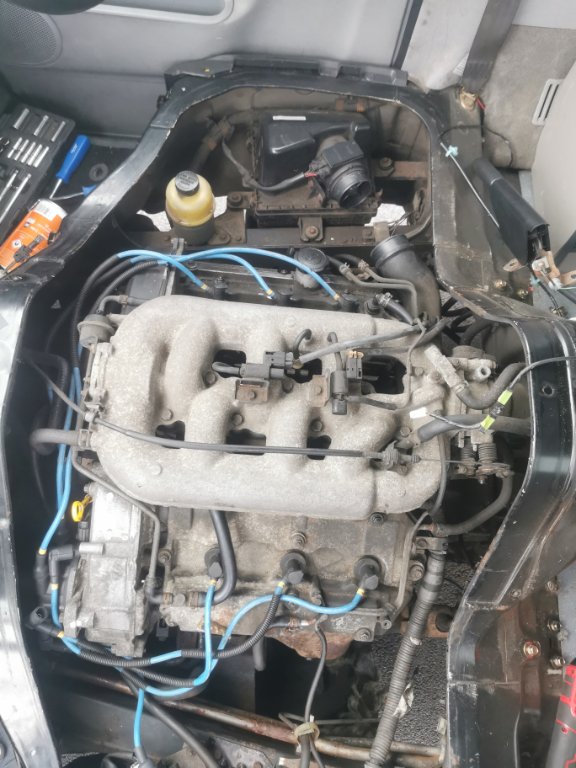

So it stayed dry today so I decided I'd have a look at disconnecting the various bits that connect the engine and gearbox to the chassis and have a general poke around.
That's the broken engine that shall be removed before I removed anything,

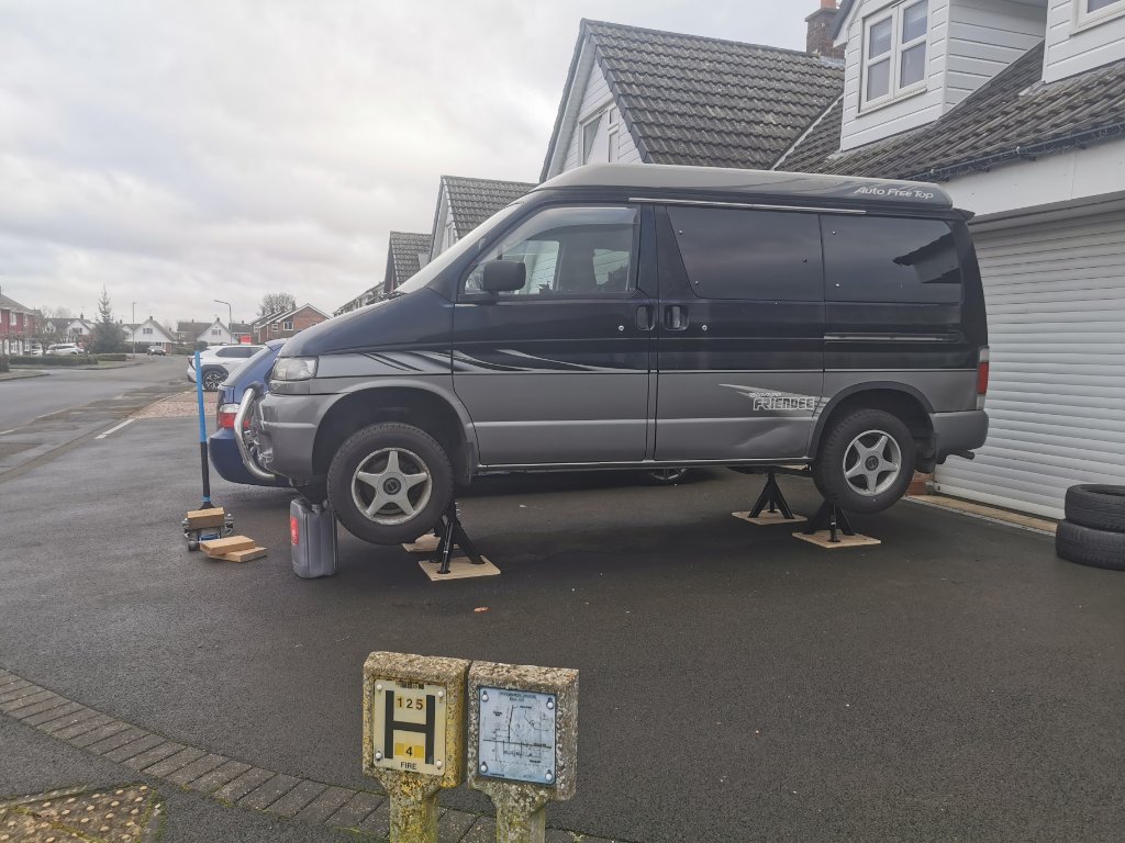

I managed to get everything off the top side quicker than I thought so I proceeded to put her on my new high lift axle stands,
With her safely raised I then removed everything from the underside
That also went surprisingly well, I'm now left with just the gearbox oil to drain, the propshaft to remove and the gearbox/engine stay mounts to undo and she'll be out.
I'm fairly sure that once I get my big jack out I can raise the chassis high enough that I can drop the engine/box onto a crawler board and slide it out in one go, when I took the other engine out in my garage I didn't have these taller stands and the dolly I dropped it onto was alot taller so I had to take the inlet manifold off the top to clear the sill..

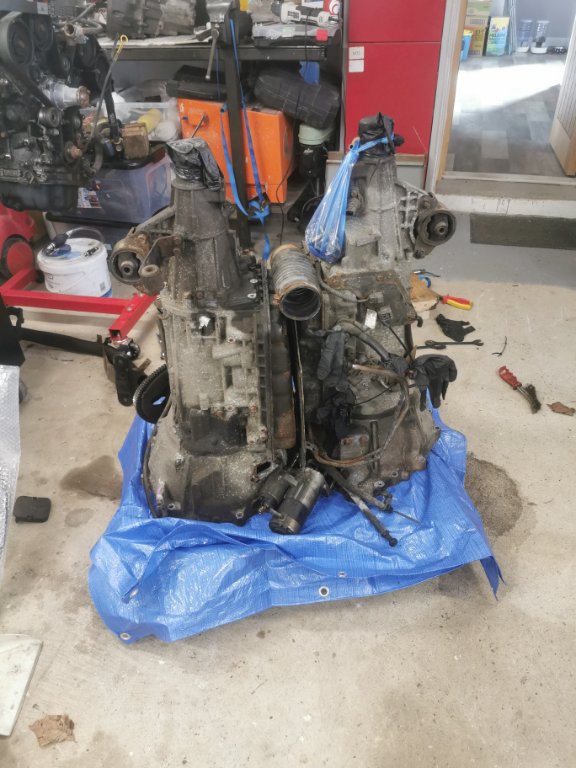

Now I'm back from holiday I spent another few hours on it today so now I've got both gearboxes removed and both engines up on stands.
Before I removed the gearboxes I decided to compression test both engines, the broken engine is severely done on compression, the best cylinder was 115psi a couple showed no compression at all and the rest were around 30 psi so somethings definitely not right with it.
The engine I'm fitting showed 4 cylinders at around 165 psi and 2 are lower at 125 psi. The 2 lower readings are a concern, given the age of the engines I'd suspect the rings want renewing but I'm not going to do it at this stage, I'll fit engine as it is and at some point rebuild the damage engine if it hasn't suffered some sort of terminal damage and then I'll have it ready to fit if it's ever needed.

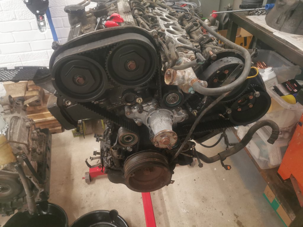

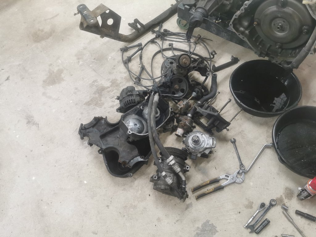

So another little bit has been done, mainly stripping the good engine so I could access the timing belt,
There's oil absolutely everywhere it's going to need a good going over with some brake cleaner and possibly the pressure washer.
I think the timing looks slightly out on the right bank but I'll know for definite when I fit the new belt and it's all clean, it may just be where the pulley sits due the belt teeth.
Everything came apart fine, the lower bolt for the dipstick has been snapped at some point so that'll need sorting but shouldn't be a big issue other than that it just seems to be all seals and cleaning and then choosing the best condition components between the 2 engines to build it back up with.
Chris.

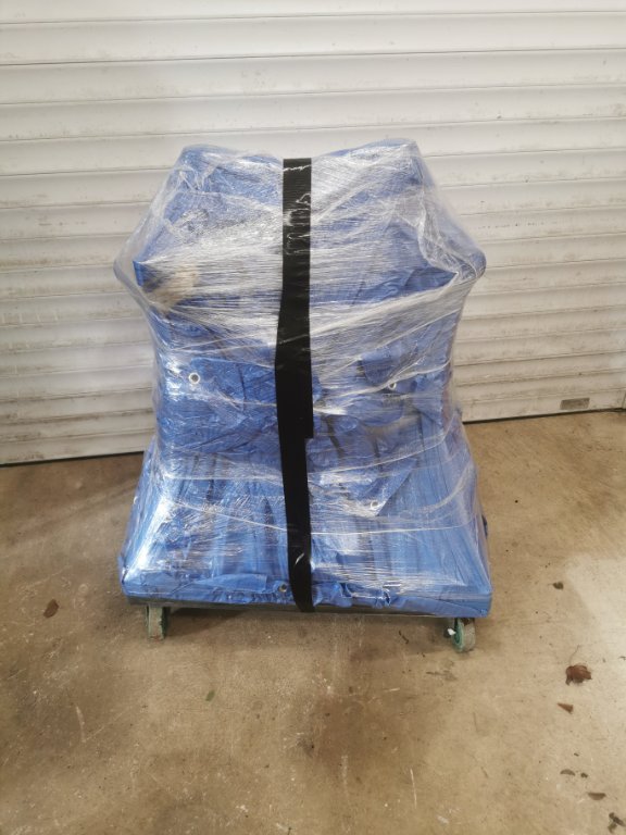

First up I needed to get the gearboxes out of my way as they won't be needed for awhile so I removed the torque converters and put both boxes on a dolly and wrapped them up to keep them weather proof as they will be living outside for a bit.
