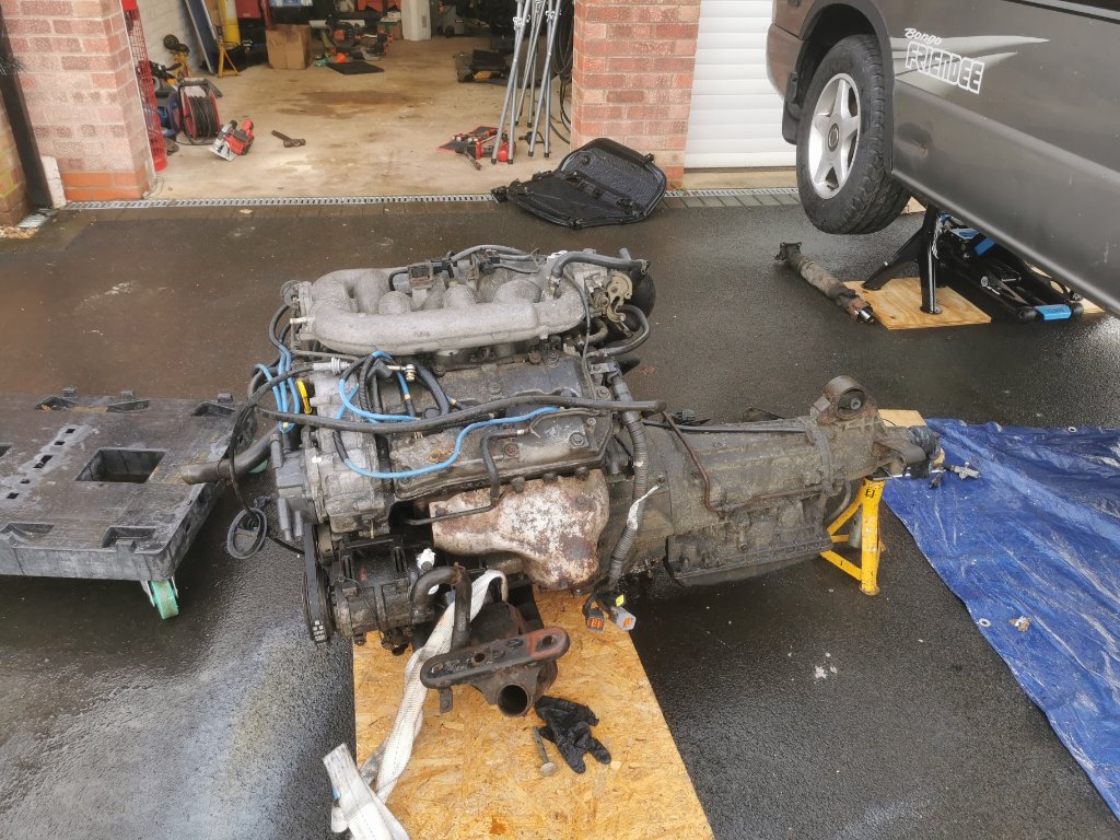

As I'd made a start on disconnecting the engine I decided I wanted it out before I go away for half term holidays on Thursday.

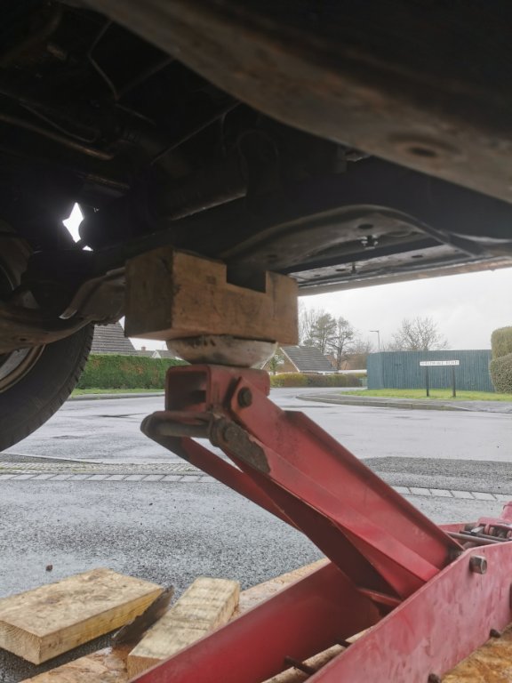

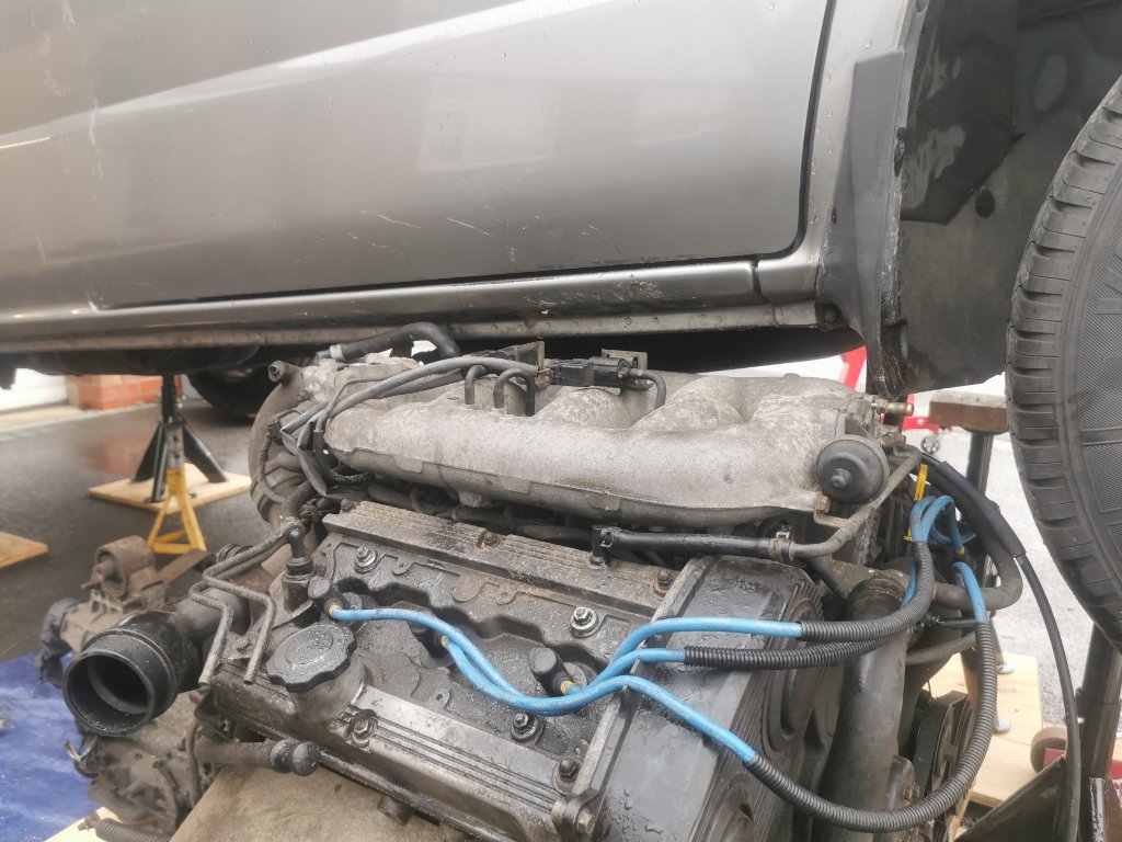

Not too many pictures of the removal, but basically I used my engine crane to drop the engine and box onto my crawler board, I then used my big jack and the home made height extender and that allowed me to just get it high enough to remove it out the drivers side with the intake still on.
Life would of been easier if I'd removed the intake but I wanted to see if I could do it with it fitted as I'd like to reinstall the engine as a complete unit when the time comes, given what I've learnt today I'm going to make an extra lifting frame at work that will locate in a couple of the subframe holes and sit into the jack saddle properly that will allow me to get a bit more clearance without Heath robinson'ing bits of wood onto the job.

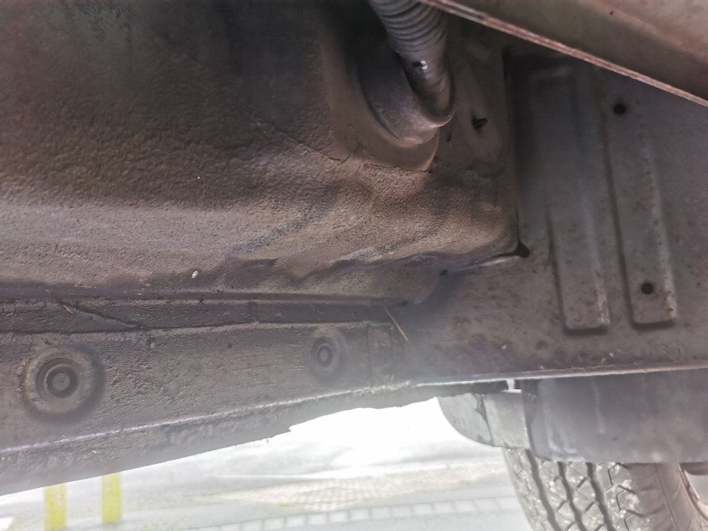

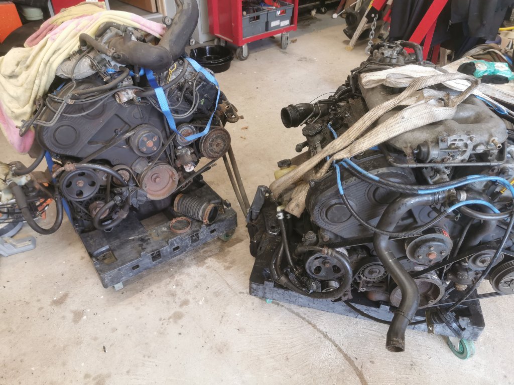

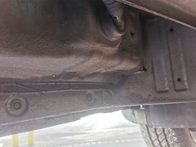

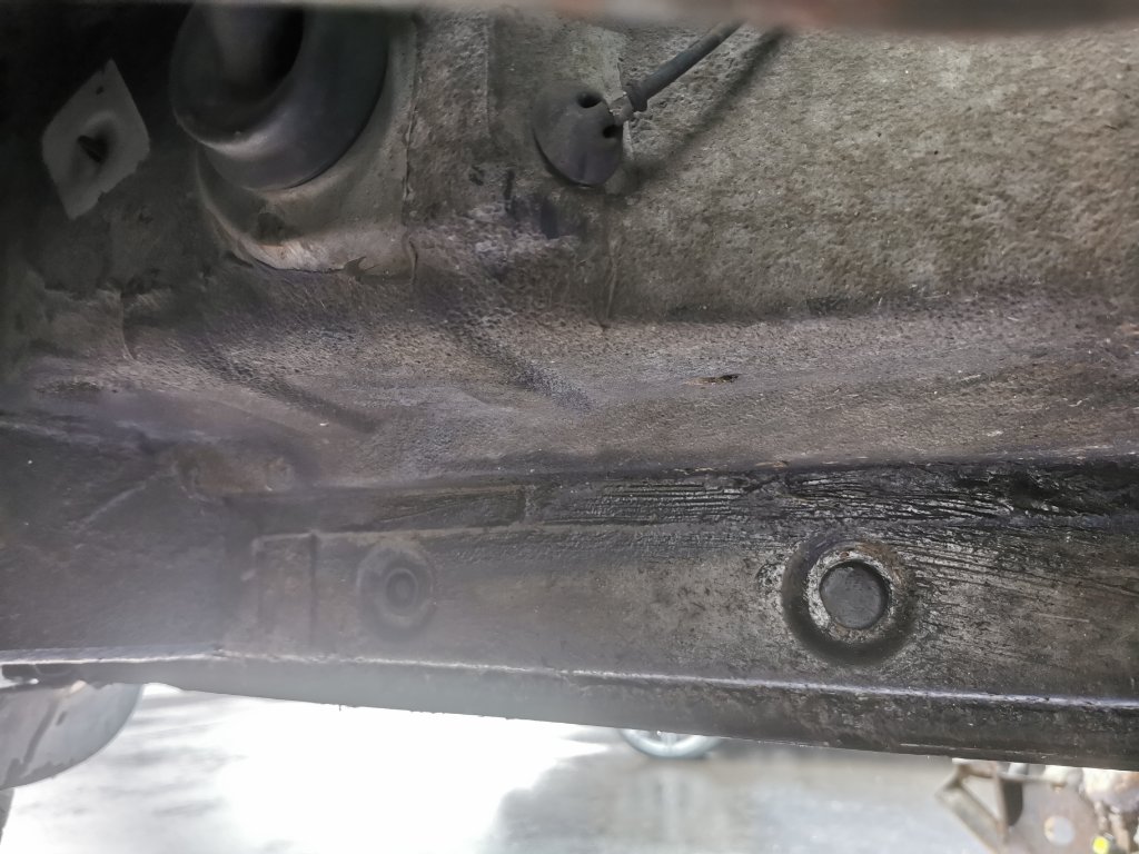

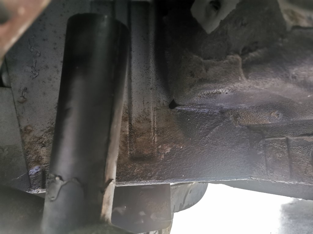

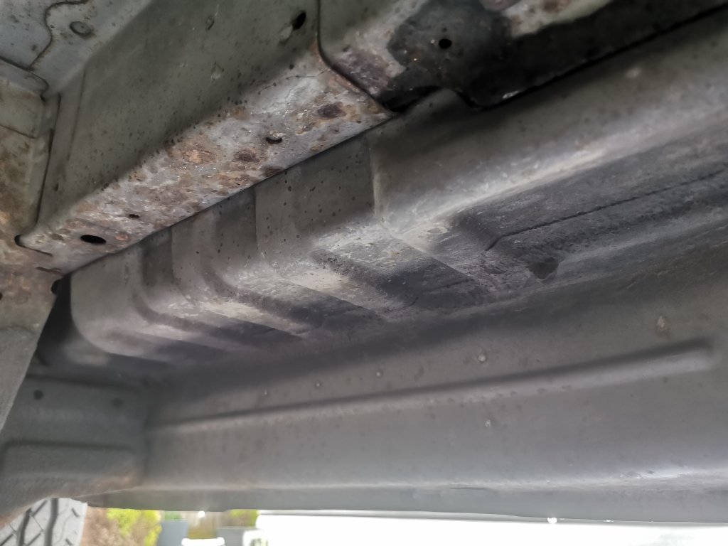

So that's both engines now into the garage, I'm going to get a second engine crane, remove both gearboxes and get them mounted up on stands at a nice working height, quite a few of the ancilleries on the broken engine are on better condition than my donor engine so I'll be chopping and changing parts to give me the best engine possible.

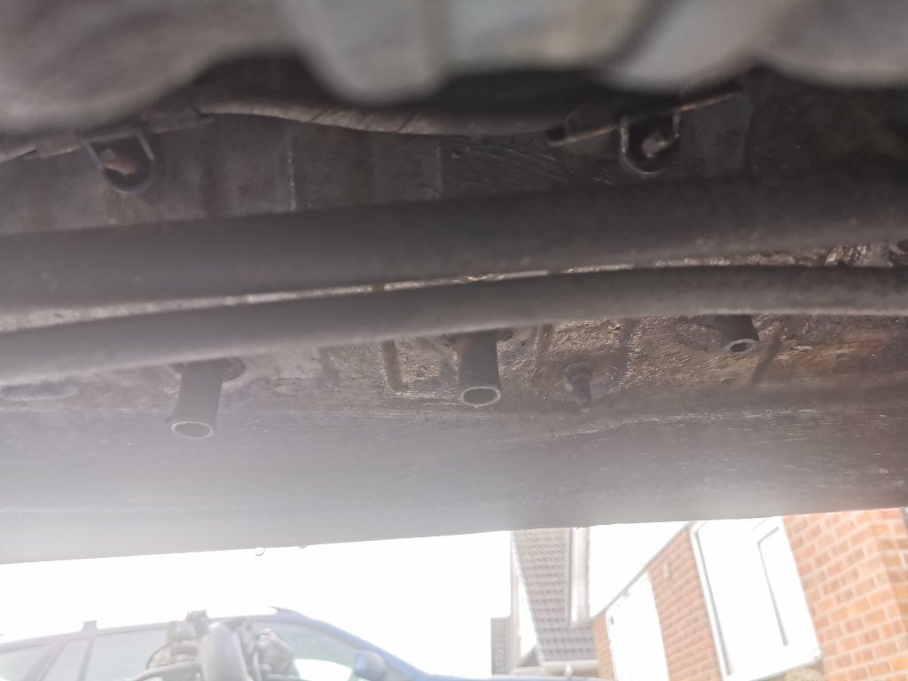

With the engine out the way I took some pictures of the underside, unfortunately it's a bit difficult to get clear pictures.
Re: Making 1 from 2 - my new bongo project
So as you can see it's really clean and tidy, a bit of surface rust which I think I'll wire wheel and treat before undersealing the whole lot.
I also plan to drill a hole in the sills at each end so I can get an inspection camera in there and then fill them with a cavity wax and cap the holes with some grommets.

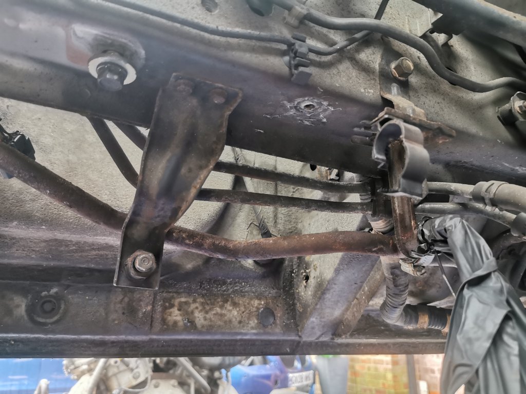

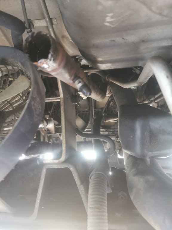

It looks like I need to replace the bottom 2 pipes due to the ends failing, the first one I'm sure was decent on my other bongo that's no longer here but that's just typical, what is the blanked off nipple for?
The second pipe is the lowest one and has failed at the end inside the glove, I believe this is the t piece pipe that goes to the rear heater matrix? The rear heater is currently bypassed due to the common matrix failure.
Given I have the side kitchen fitted would I actually get much heating/cooling out of the rear heater as it's effectively blocked at the side by the fridge so the only open vents are the rear facing ones in the roof, I'm more interested in getting cooling to the rear when it's hot rather than warm air, but if I'd only get little flow from the top vents it's probably not worth the effort but I'd welcome your thoughts?
That's it for now,
Chris.
My thoughts are that is where they fill the coolant when at the factory, it's not on the drawings of hoses and pipework as I remember.... Check it's not rotten if you take the clip off..

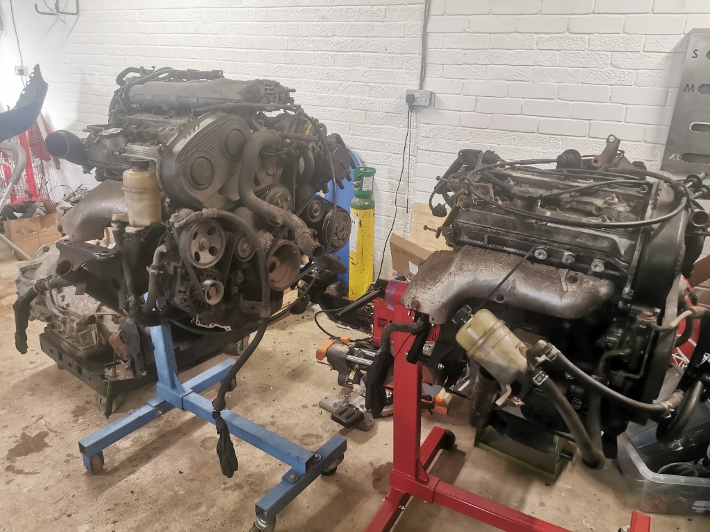

Now I'm back from holiday I spent another few hours on it today so now I've got both gearboxes removed and both engines up on stands.
Before I removed the gearboxes I decided to compression test both engines, the broken engine is severely done on compression, the best cylinder was 115psi a couple showed no compression at all and the rest were around 30 psi so somethings definitely not right with it.
The engine I'm fitting showed 4 cylinders at around 165 psi and 2 are lower at 125 psi. The 2 lower readings are a concern, given the age of the engines I'd suspect the rings want renewing but I'm not going to do it at this stage, I'll fit engine as it is and at some point rebuild the damage engine if it hasn't suffered some sort of terminal damage and then I'll have it ready to fit if it's ever needed.
