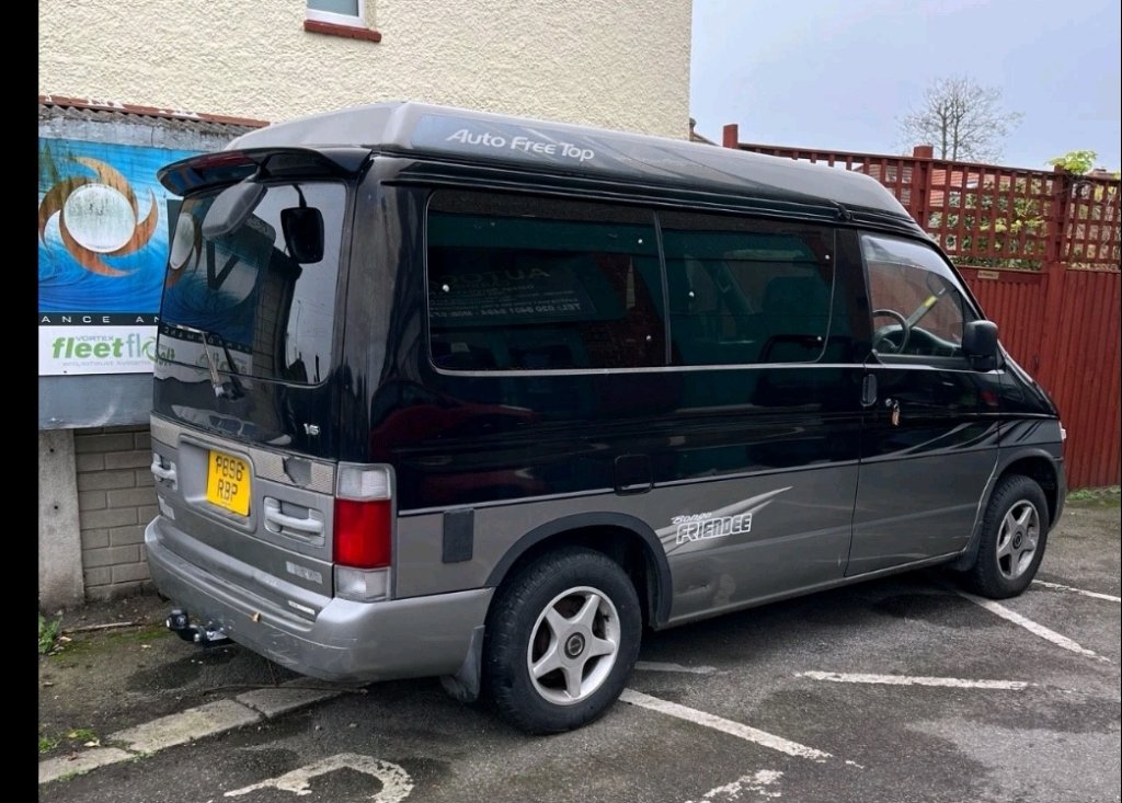

That's the rusty one there, looks quite deceptive but drivers sill has gone completely all, the way up into the main floor.

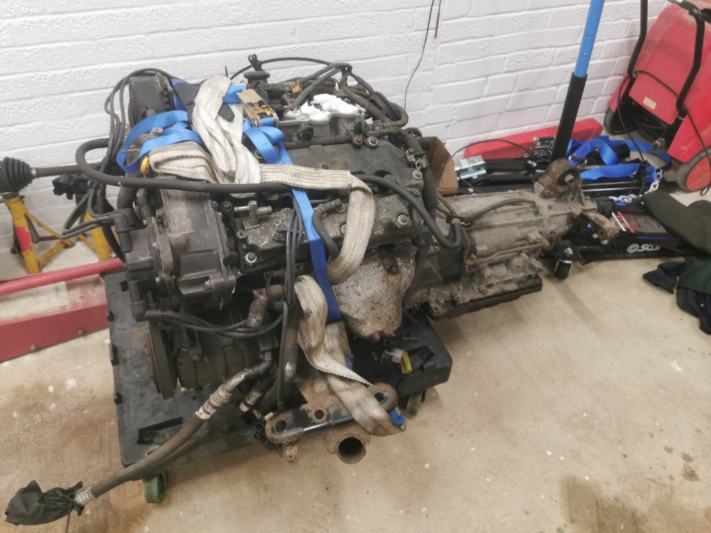

That's the engine and box out of the rusty one, it took me and a mate 5 hours to remove but I was rather brutal in cutting anything that didn't want to come undone, I will need to be alot more careful with the new chassis which means it'll be alot longer.

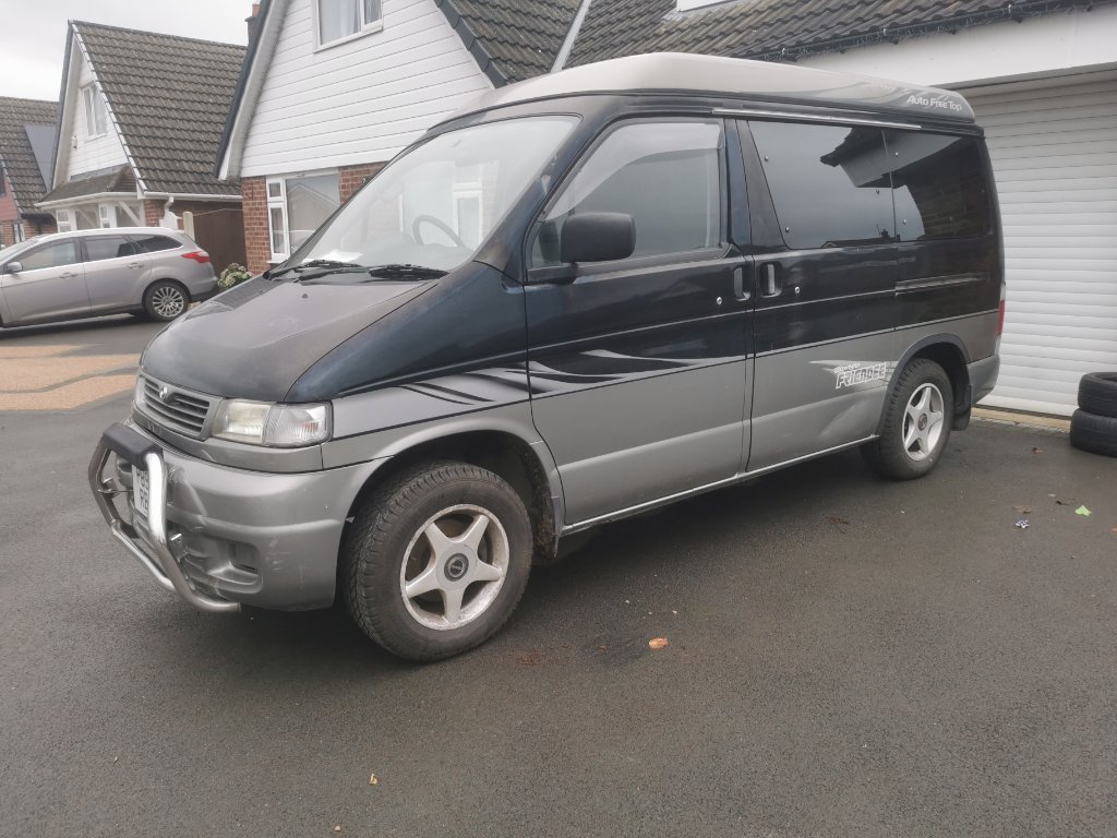

Enter the new bongo, she's got a few marks but given the age I'm fine with that.
I plan to remove the broken engine and box in March, this will be followed by a good look at the chassis which. I'll do any necessary repairs on and under seal.
The new engine and box will go in and then I should hopefully be good to go for the summer, I kept a few bits off my old bongo that were in better condition so they'll also get fitted.

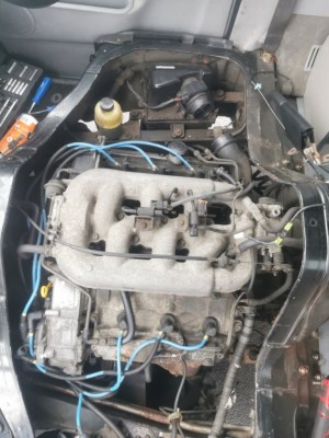

That's the broken engine that shall be removed before I removed anything,

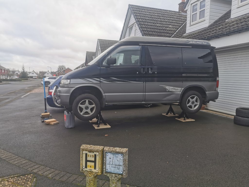

I managed to get everything off the top side quicker than I thought so I proceeded to put her on my new high lift axle stands,
With her safely raised I then removed everything from the underside
That also went surprisingly well, I'm now left with just the gearbox oil to drain, the propshaft to remove and the gearbox/engine stay mounts to undo and she'll be out.
I'm fairly sure that once I get my big jack out I can raise the chassis high enough that I can drop the engine/box onto a crawler board and slide it out in one go, when I took the other engine out in my garage I didn't have these taller stands and the dolly I dropped it onto was alot taller so I had to take the inlet manifold off the top to clear the sill..
