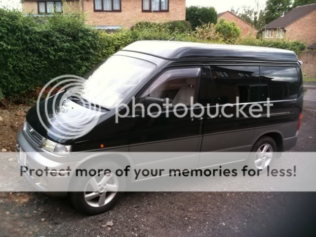

OK working this out, picture of Samuel
http://s924.photobucket.com/albums/ad90 ... 7bbd56.jpg

i remember this bongo as i was the 1 who told ian to fit the mazda 6 alloys on to it and what a nice motor it was and still is by the looks of things

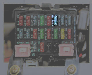

Its just as easy as any of the existing ones, the two fuses concerned are;tgeorge1 wrote: is it a big job to get the blinds to run off the leisure battery too
Rather than actually intercepting / cutting the wires behind the fuse block, just take two more 15 Amp feeds from the added L/B fuse box and plug them in from the front like this by removing the existing fuse and plugging the L/B feeds into the lower part of the fuse socket;
If its a Willinton kit that has been used then you should already have a pair of feeds already existing.

Nice
Re: Amateur Bongoer
Very nice looking Bongo.
