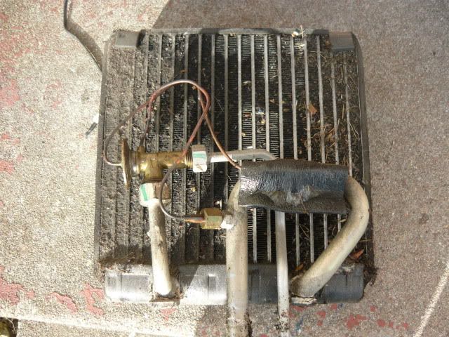

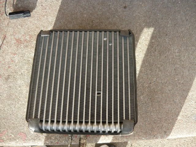

brorabongo wrote:I'll be removing that rad in mine when next under the bonnet, as the rest of the air-con has been moved anyway. The only problem....could insects now be blown directly into cab?
Been under bonnet sooner than expected, tried to refurb the heater fan motor again...but no luck. :(
I've removed the element for the front air con. Even with a dodgy fan more air is coming from the vents now. :D
Is it likely anyone would need to replace such an item? i.e. should I keep hold of it?

Doone wrote:Yes keep hold of it, they can get damaged from stones flying through the gaps in the bumper etc. On our 'around tuit' list, we are going to put fine mesh behind the gaps, to prevent this from happening... either chrome type, or colour coded mesh of course. :wink:
This is the little rad inside the ducting bolted to the bulk head, not the rad in front of cooling rad. That rad was disposed off a while back. Made a difference to the cooling rad. :D
You could see on the old cooling rad where the air con rad was placed, due to lack of dents in that area.
I'll keep hold of it for now. Wrong section but if anyone wants it, it's yours for the cost of postage. It's heavier that it looks mind!!!
