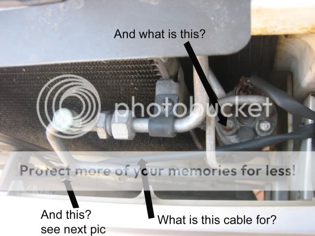

Any ideas what this is?
Post by widdowson2008 » Sat Apr 17, 2010 4:08 pm
Just generally admiring the Bongo and checking levels when I noticed this new (to me) bit.
The pics were taken looking down at the radiator (air con)
Don't you get a little weary of suddenly finding something you aint seen before?
The obvious answer is stop poking around :roll: but I cant do that :cry:
Steve

Don't know about the cable but the unit with the sight glass is the a/c dryer - if the a/c is working ok you should see activity in the sight glass when the engine is running and a/c switched on

dandywarhol wrote:Don't know about the cable but the unit with the sight glass is the a/c dryer - if the a/c is working ok you should see activity in the sight glass when the engine is running and a/c switched on
Thanks Alan - right again =D> =D> - activity noted in sight glass and aircon seems to be doing its thing (cools off the cab area very well)
So.......if the sight glass (about 10mm diameter) is on the a/c dryer, what are the cables for?
There is one coming from the dryer to something off to the right, and then back from the 'something to the right' down to a 'block' on the centre stay (front or a/c rad.).....and there it stops. Could this be yet another sensor? I feel an urge coming on to grab a shovel and do a bit (more) digging. :roll:

Its a high pressure switch. If your aircon pipe gets blocked (Usually at the expansion valve near the coil in the dashboard) Pressure can rise very quickly. They are usually set to 30 Bar if my memory servies me correctly. The wiring will end up somehow sending a signal to the clutch plate on the compressor, and will simply turn it off if the pressure gets too high. Hope this makes sense... Patrick (Retired Vehicle Air Con Engineer!)

ptatham wrote:Its a high pressure switch. If your aircon pipe gets blocked (Usually at the expansion valve near the coil in the dashboard) Pressure can rise very quickly. They are usually set to 30 Bar if my memory servies me correctly. The wiring will end up somehow sending a signal to the clutch plate on the compressor, and will simply turn it off if the pressure gets too high. Hope this makes sense... Patrick (Retired Vehicle Air Con Engineer!)
Hi Patrick
Thanks for that. So it's a HP. switch. What is the reason for locating it there? Seems to be out on a limb - remote from just about everything. If the answer is complicated and can't be explained to a thickie, (like me) leave it. Just wondering thats all.

yep agree with all of that, speaking from experience of changing the Air Con rad and drier bottle.... :( after the Pheasant episode

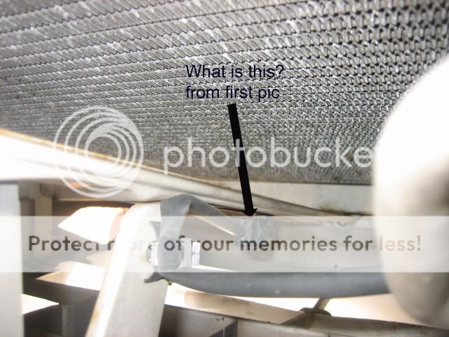

The item in the second picture is some form of sensor, probably temperature or air flow. I can't see it being a high pressure switch as it has no mechanical connection to the refrigerant :? . BTW, I have no experience of aircon, but have disconnect it when doing some work on the front of the van.

widdowson2008 wrote:Just generally admiring the Bongo and checking levels when I noticed this new (to me) bit.
Asked this before. Not sure about the answers I got. (2nd pic - got an answer to the first pic)
Looked at 3 other Bongos and none of them have it. Is this the elusive Dilithium crystal?
Anybody else got one? and if so, what the hell is it :? :?
Steve

Mine has one :) Sorry no idea what it's for :(

In the wiring manuals its marked as G3-25 (Electronic version) G1-09 (Manual version) and referred to as Pressure Switch Electronic/Manual A/C
Same location for the connector on both types it looks like

g8dhe wrote:In the wiring manuals its marked as G3-25 (Electronic version) G1-09 (Manual version) and referred to as Pressure Switch Electronic/Manual A/C
Cheers Geoff.
Still baffled on 4 counts.
1 - What is it for? (perhaps the earlier reply from ptatham, the air-con guy, was right after all - thanks Patrick)
2 - How does it work?
3 - Why doesn't it appear on ALL Bongos?
4 - Geoff - Do you know where it manifests itself on the wiring diagrams? That might give us a clue.

Click the images above, to go to that page in the Wiring Manual, then go back one page using the arrows at the bottom, and it gives the circuit but only as much as it feeds into the Air Con, electronics.
