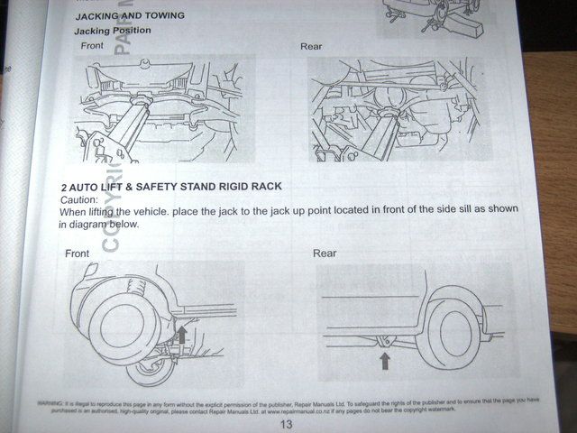

i think i'm going to try jacking it up and loosen the nut underneath. where does the jack fit underneath the car?

just tried that and can't get the bloody nut off :roll:

Don't work underneath the vehicle on a jack.
Not for anything.
Good luck.
Anyone near with ramps? Possibly drive 2 wheels on kerb?
If you have Halfords nearby you could buy a breaker bar to crack the nut.
