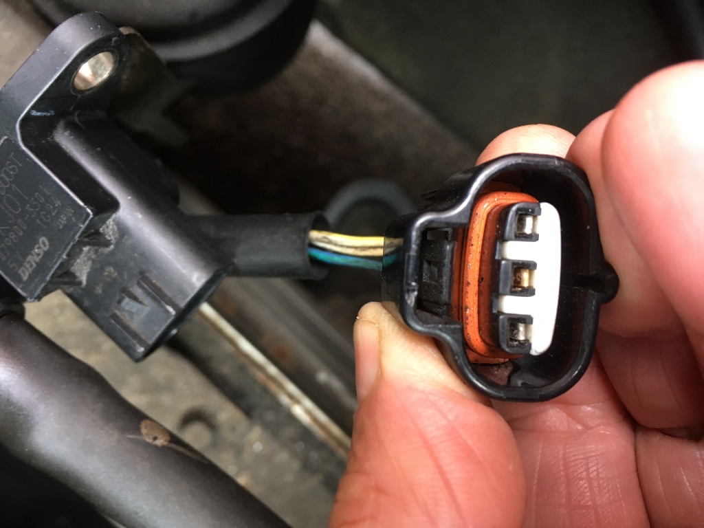

Might help if you could show us a picture of what your looking at ?

Hi g8dhe,
Thank you for your reply, any information on this sensor would be much appreciated.

It doesn't look like a solenoid with three connections, the colours match the circuit diagram on the connector, as well as the connector style.

Re: Sensor boost solenoid
Any part numbers on the body of the part?
Can you put up another image or two of the oart and one with it in situ.

Right its the Boost Pressure Sensor mounted on the intercooler piping - 18-211D original part#:KJ0118211A
http://www.lushprojects.com/bongopartsm ... mgno=.html
its on versions after 1999 it seems.
It measures the air pressure in the intercooler.
