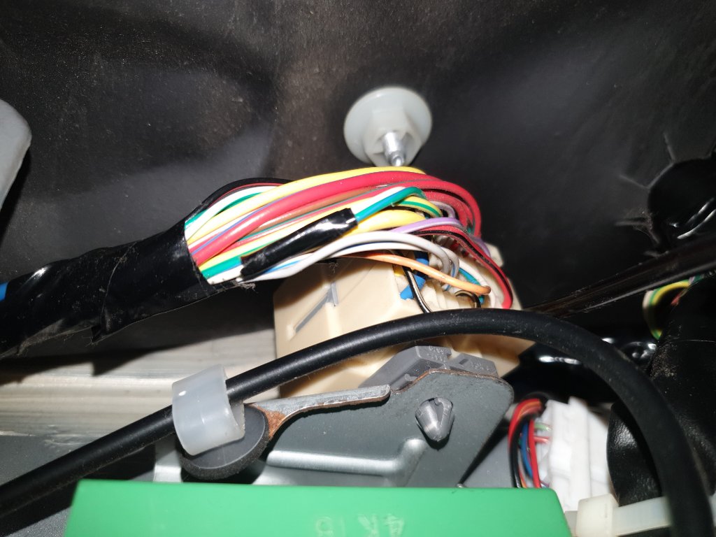

Disconnected the dashboard and fuse blew again so not coming from here.
I guess like HairyBeard did I should be disconnecting looms on both side (near glove box and close to gas pedal) that go to clusters, it would help me to figure out if short comes from the front or the back of the vehicule right?
Never came across those connectors, any tips on disconnecting them? Can see a grey T shape piece in the middle that looks like it wants to be pushed.
