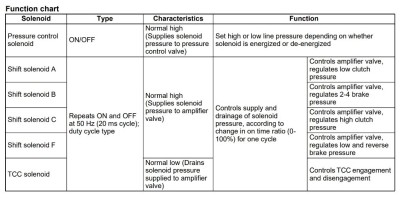

A meter isn't going to be of any use its a pulsed system and its the % of the duty cycle that determines the position, its pulsed at 50Hz and the On period compared to the Off period that determines the selection;

g8dhe wrote: Sat Feb 08, 2025 4:09 pm A meter isn't going to be of any use its a pulsed system and its the % of the duty cycle that determines the position, its pulsed at 50Hz and the On period compared to the Off period that determines the selection;
I have a scope too. I just have no idea where to probe.
When it wants to activate a solenoid it goes from ~0% to ~100% to make a smooth change or something?
Thanks.

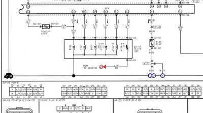

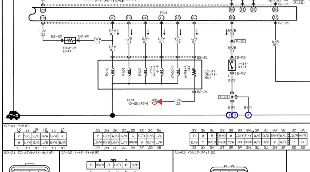

The connections for the diesel are on the diagram below, the ringed numbers relate to the ECU pin numbers and the colour codes are against each wire;

g8dhe wrote: Sat Feb 08, 2025 5:23 pm The connections for the diesel are on the diagram below, the ringed numbers relate to the ECU pin numbers and the colour codes are against each wire;

I have no idea which node(s) will tell me if 4th gear is being commanded.
If someone knows, please help :)
