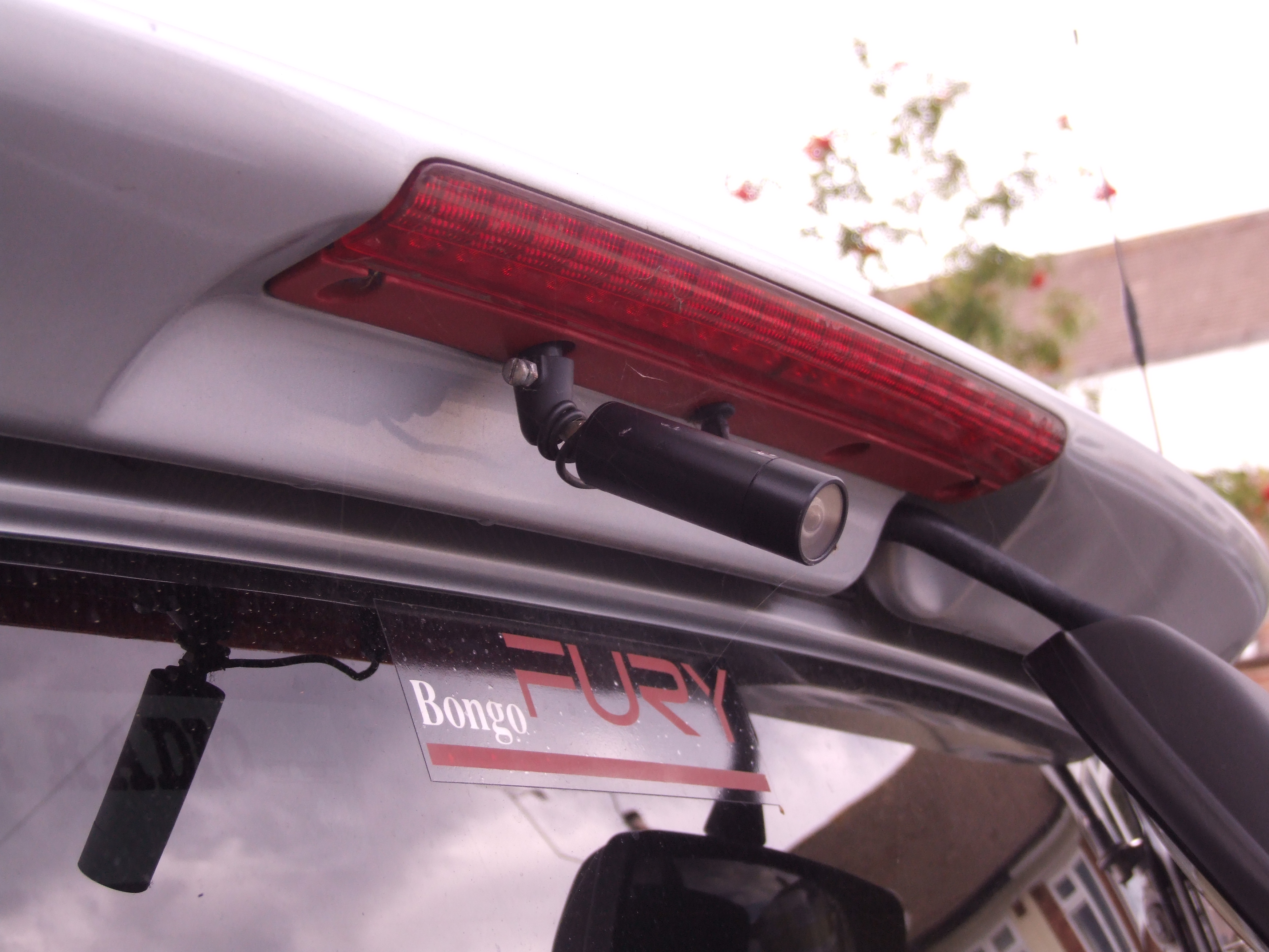

You want it up high so that you can look down on the view, otherwise its very difficult to make out the distance. Obvious place is the High mount brake light!
Then if you remove one bolt and replace it with a length of threaded rod you can put a nut back on to hold the light and screw the camera on to the bottom of the thread. A hole with rubber sealing grommet in the middle and your then into the end of the wiring loom and can pull your cables back into the the rest of the van using the same path. Just take care going thru the rubber sleeve into the main body of the vehicle.
Final view will look like this;

Cheers Geoff, weather permitting I will attempt to fit tomorrow :D
