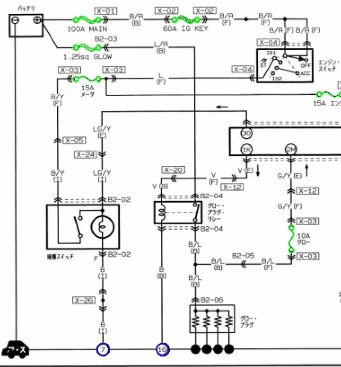

So for 2 days I thought I had cracked it, even took it out yesterday admit was fine the entire trip but today, same issue. So I have checked and cleaned more wiring and connectors but I am honestly not finding anything wrong, although it was fine when I left it this evening, so I might have fixed it (again)I am wondering if it is possible the wires on the GP relay have been replaced incorrectly? Does anyone have a diagram or picture of the colours of the wires and where they go. I found a Japanese wiring diagram and it was helpful but there didn't seem to be colours.There are 3 plugs one with 2 terminals in a "T" configuration, so I don't think that could be wrong but the other 2 are single terminals similar size etc, I know there is a blue/red wire and the other is blue and something,maybe black but they could easily be reversed?
Also does anyone know if there is a separate 'timer' for the Glow plugs and if so where it is? If so could this be playing up?

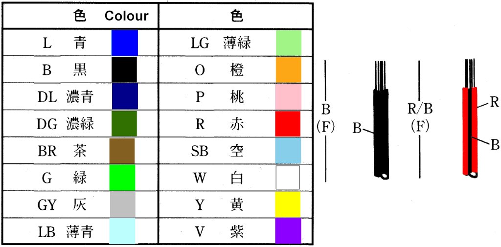

The colour codes are beside the wires;
The wiring;
However if the Glowplug light is flickering as opposed to flashing then this suggests that there is a poor power connection. If it flashes then its the ECU reporting an error. The glowplug light is ONLY a timer it doesn't show the state of the glowplugs at all.
