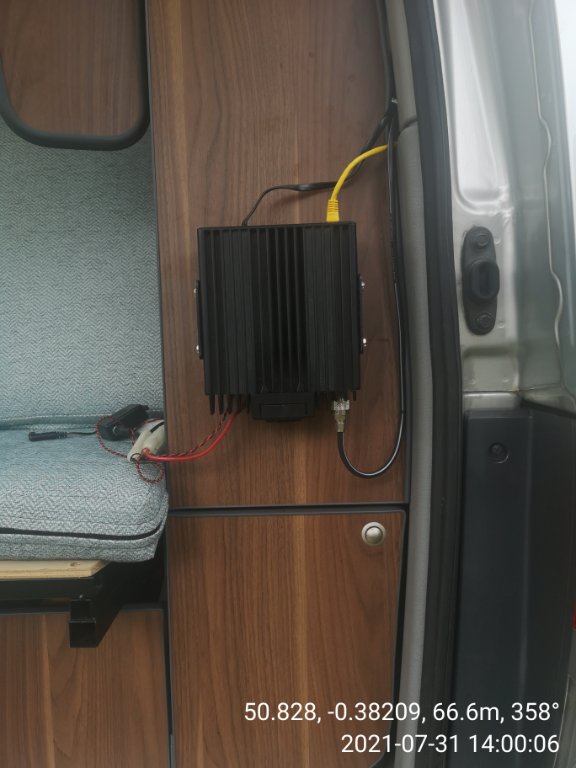

Post by g8dhe » Thu Oct 07, 2021 1:22 pm
Yup the HAB activities are quite fun, although they have slowed down quite a bit in the UK for the last couple of years!
Nearly first thing I did was re-install the radio in the new vehicle IC-2800H,
