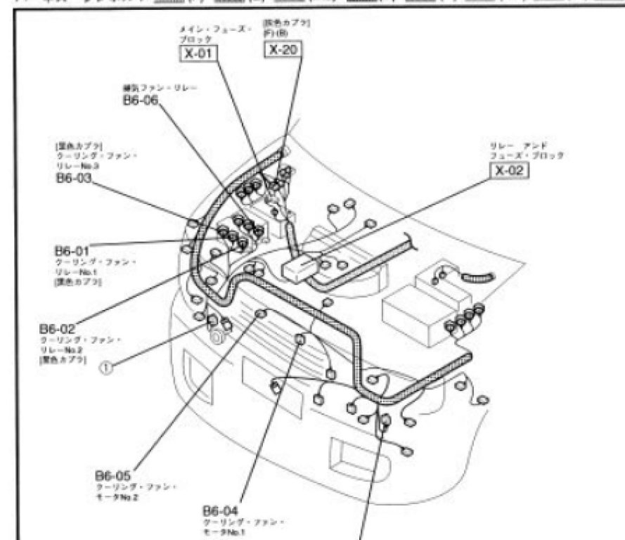

Okay, I give up! Can anyone tell me where I find the scavenger fan relay on my 2000 2.5 Diesel please?
It's no longer working - so I can't listen for a click. As the scavenger sensor is good and the wiring to and from the sensor is sound (and the fuse hasn't blown) I think the problem must be a defective relay. But where do I look for it?

Its B6-06 second row of relays in front of the drivers position on the right, or it was upto 1999 at least
Its fused from the 30 Amp ADD Fan both for the motor and the relay.

Those six relays have moved to just behind the front panel alongside the radiator on the later model, but I spotted them easily enough when I knew what I was looking for. And to my considerable relief the scavenger relay proved unreliable under testing.
For next week's trip I've removed the dodgy relay and wired across the motor supply terminals to a fused switch just below the dashboard. I'll order a new relay when we get back home.

Yes the diagram isn't the best for precise location
They have also been known to move various relays around on some versions without apparent reason! The covers on those relays do pop off and then you can gain access to clean contacts if required.
