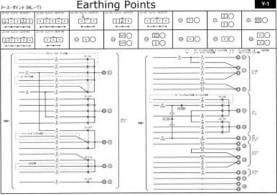

Have you checked all the earthing points that exist? Some of the symptoms are typical of multiple failed earth connections, a lot of the earth connection points, but not all, have a common connection to them as well as the individual circuits needing earthing, hence its critical to check all earthing points as its likely that more than one has failed!

Forgot to say, I did check and remake all earthing points I could find. It still was playing games.....
